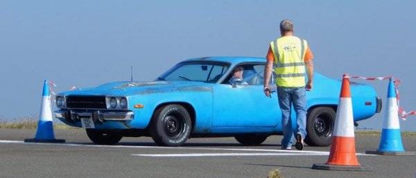

well i wont be helpful but i do like being involved LOL! mine is riding on stand tires right now. 205/75R14 Ironman radials(cheap chinese). i picked them up new for 49 bucks a piece from my wholesaler

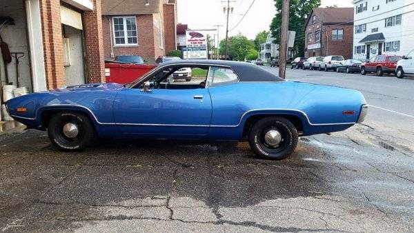

To me the 255/60/15 fills the wheel well like I'd have done it from the factory.
All that room and E78 14 factory is crazy.
However, I think it would look better if the wheel had a little less backspace and a little more dish.
I test fitted some 265/50/15 on 15x7 keystones and that look is perfect, period mid to late 70's day two.

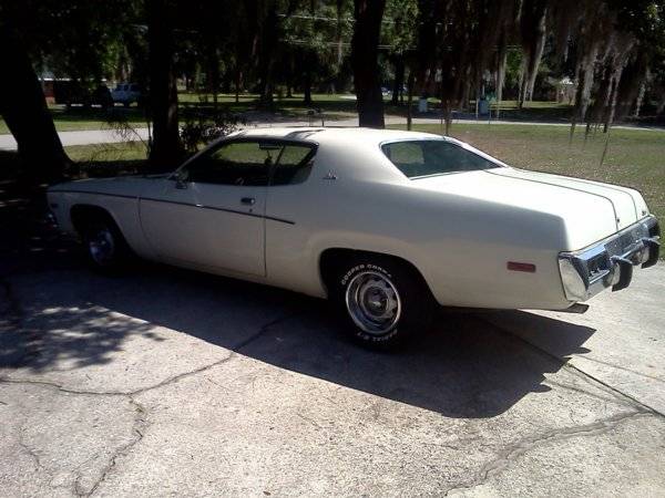

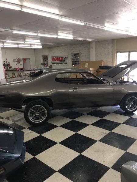

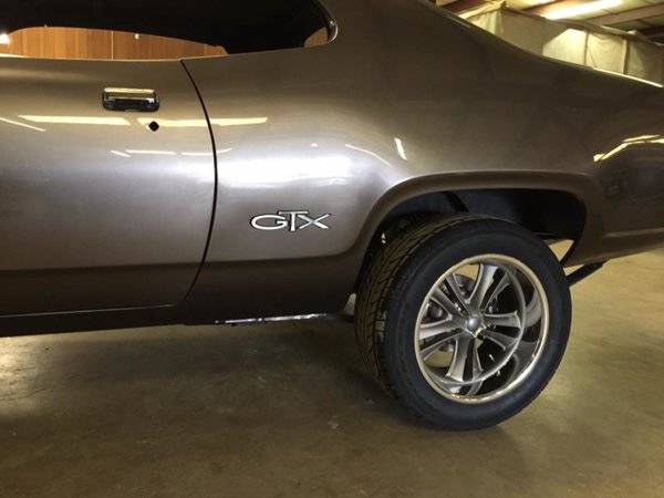

You’ll find my car’s pic on the mentioned thread. 15x7 3.75 BS 255/60-15 all four corners is THE combo to get an upgraded performance setup on still kinda stock look
295/45xR18 in the rear (Nitto Xtreme) and 245/45xR17 (Nitto Extreme) for the front. Wheels in the back were 18 x 9.5.
Wow. Normally I don't like "modern" style wheels on our classic body lines, but those look good.
