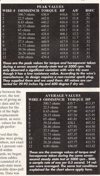

The wires are a crap shoot, as the test below shows. Use NGK 5 heat range plugs.
