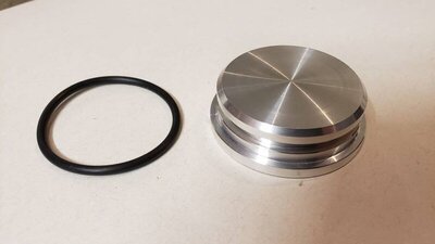

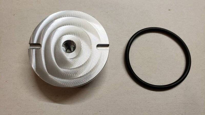

Here U go... This guy provides a nice machined plug..
[email protected]
Just my $0.02... ;)

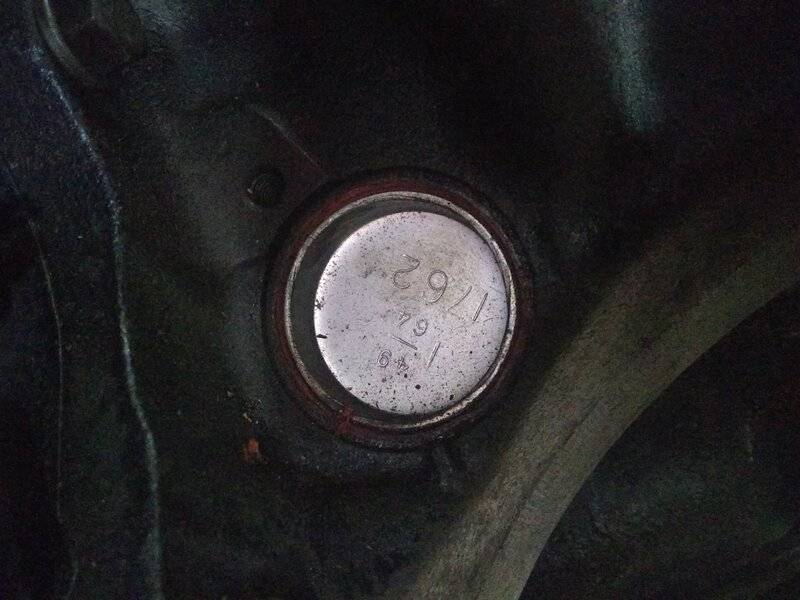

I was playing Patti cakes with mine today.
