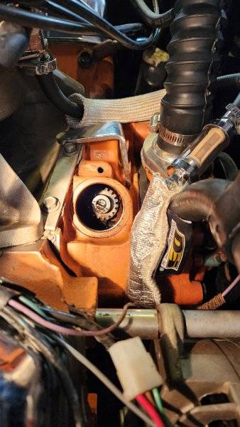

You didn't need to touch the intermediate shaft... That
s why I didn't mention it.... Now that it's been changed set the engine back on #1 TDC on the compression stroke... And aim the intermediate shaft like this...
Then install the distributor with the rotor pointing to about 5 O-Clock
5:00 while looking from which position? The one shown in the picture? With the shaft at that angle, my rotor is either pointed at 8:00 or 2:00.
If you are talking about from the front of the engine, then yes the rotor's pointed at 5:00.

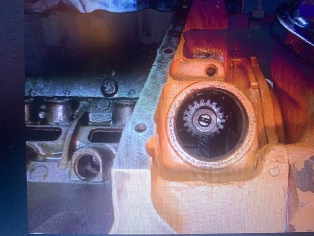

Rotated engine around to my original starting position. Engine is a top dead center, rotor is where I originally started. I'm still verifying top dead center with the spark plug hole, but general question for clarification: If the engine was a top dead center of the non-compression stroke, the distributor would be flipped around 180°, correct?
Anyway, rotated intermediate shaft as advised above.
Rotor now points to 5:00 if looking at it from the front of the engine bay.
I can't view the replies while typing this from my phone, but if I remember correctly, I want to move the pick up coil and the number one spark plug wire location to where the rotor is now pointing. The 5:00 position, as in my picture below. Am I close??
