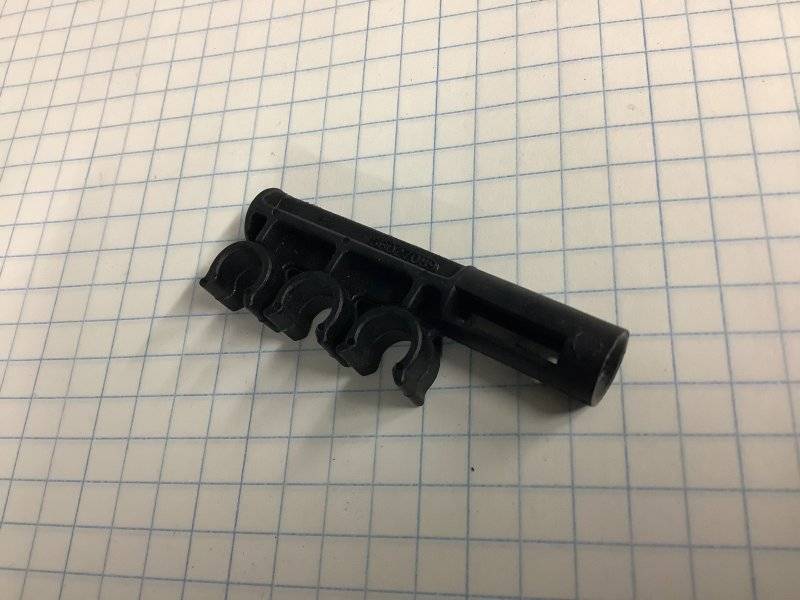

What are you guys using to make a neat clean look for a big block with headers? I did a search saw a couple posts this is a 383 in my 80 volare previous owner does jot have a clean set up looks sloppy, thanks. Brett

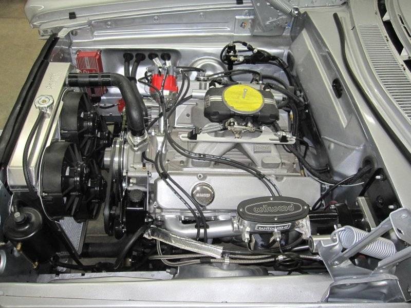

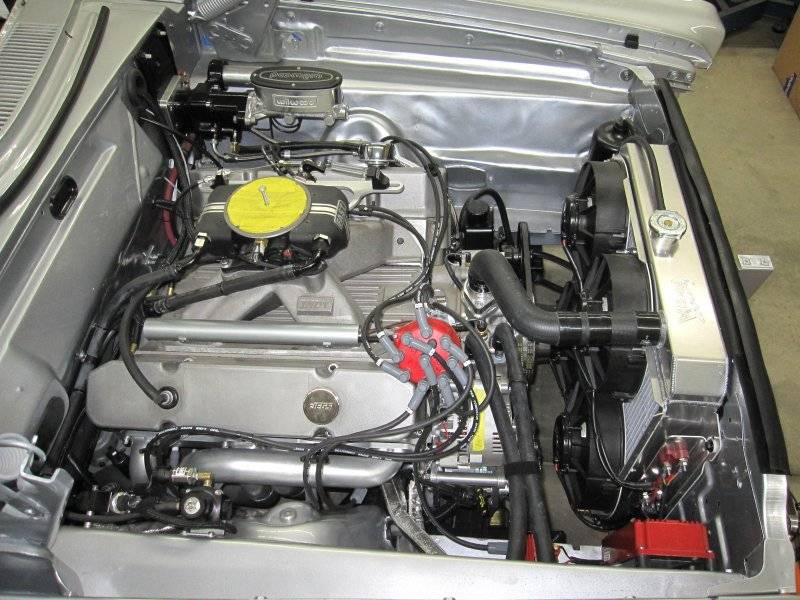

I used plug wire looms from a mid 90’s Ram 360. They slide over and lock securely on a 1/4” stud and can be found in 2, 3 and 4 wire configurations.
Up front I use the factory retainers…
