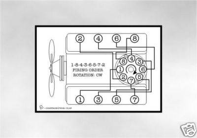

distributor cap is confusing , if anyone has a diagram that would be great
SB firing order is Clockwise, above diagram is for big-block only..
This is yours:
now i'm really confused my old wires 1and 8 wr at the back closest to fire wall
Welp...your best bet might be to re-time the engine then. Bring it back to #1 TDC on the compression stroke, and see where the rotor is pointing, that will be wire position #1.

Firing order is clockwise for your 318..
wow what a mess, you think i would learn, my 55 crown distributor was 180* out and it ran so bad ,i almost had to push it home after driving it 200 miles from wr i bought it .
ok #1 TDC ,timing mark at 0, rotor is pointing at #5 on your photo, yes my car is clockwise.
Right now my #1 is at the fire wall and firing order 1-5-4-2-6-3-7-8 "YIKES"

Remove distributor hold down.
Lift up distributor.
Rotate your rotor 180*.
Reinstall distributor.
Put hold down on.
Put plug wires in correct location per diagram from above.
Should run if everything else is correct.

I pull #1 and bump the engine over until the compression forces your finger out. Line up #1 on the balancer with the timing tab. Pull the cap and make sure the rotor points towards #1. If it doesn't you can turn the gear by backing it out with a screwdriver into the slot until you get it into position. Firing order is of course 18436572 going clockwise. Start #1 on the cap where the rotor points and plug the wires in accordingly. Cylinders 1,3,5 and 7 are on the drivers side and 2,4,6 and 8 are on the passenger side. Set like this the timing should be close to 0° advanced and will usually get you started. Use your timing light to adjust the timing to spec or 10+° before top dead center. (BTDC) I just noticed that some of the diagrams on the internet show the rotor pointing towards #2 (passenger side front) Boy that can screw you up. I posted this because I don't know how knowledgeable some of you are. This is how I do it.

1-8-4-3-6-5-7-2 has been the firing order for ever. #1 is always at the front of the engine, drivers side. Wow.
No excuse for not having a service manual. The downloads are free. Here is a diagram to set the distributor and wire the cap to factory specs. Also a link to download a free service manual. It will be your best friend and answer most questions you will ever have.
