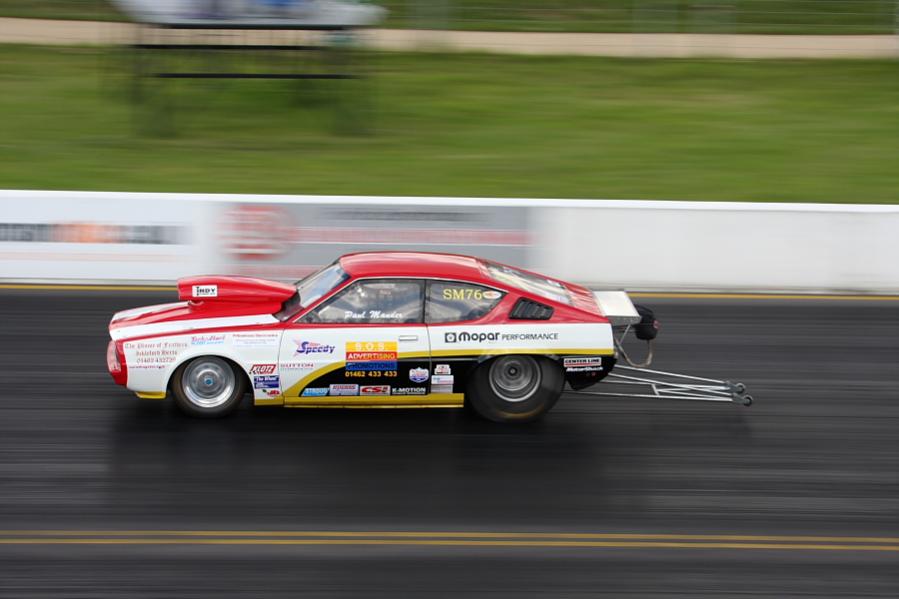

Mate of mine put a stroked 383 in his Arrow and ran a best of 7.7 @ 180-odd :eek:
And yes that's 1/4 not 1/8 mile :icon_wink:

that is a beauty!!!! how did you mount that engine there and what kind of modification need to be done, for the street. who supply the parts. thanks
Not my car so I dont know all the ins and outs. The car has now been sold without the engine to a woman who's running a Ch*vy engine, and has only managed a 9-something 1/4 so far :laughing7:
The 383 stroker need a bit of NOS to get 7's but he did manage an 8 without. Engine's up for sale and someone with a 'pro-touring' style Challenger was looking at buying it last week for street & strip use. So he obviously thinks it's suitable for the street without too many mods.
