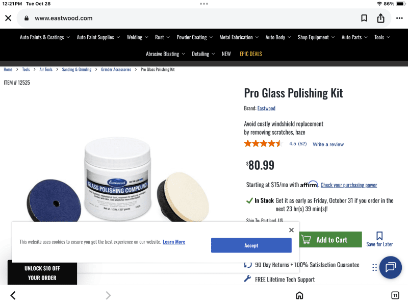

This what I had successful with for very minor scratches
