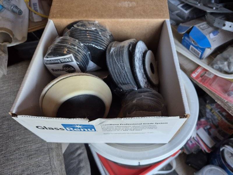

I bought one good kit on Amazon. Came with 5 sheets of everything from 320 to 5000 grit. Included the backing and buffing pad. I think it was $30. No compound. Good deal but like I said, still wouldn't recommend it unless you a real sucker for punishment.
