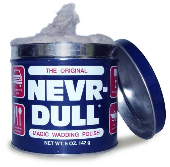

Ehh haven’t dealt with scratches, but for a good polish up I’ve always used “nevr dull” they are not kidding when they advertise “magic wadding polish” on the can. This **** WORKS

This stuff does work, I remember when I was in the Navy seeing ship's company using that stuff everywhere, from brass, to chrome, to aluminum. The cotton would turn black in a heart beat, but boy did the metal shine. Never used it myself, but I might go buy a can and try it on my hub caps.

I still have 2 cans of the original in the pic I posted above, all I can find now is the eagle one brand but it seems to work just as good. I took a big ole hunk of it to my buddy’s rusty bumper on his Chevy blazer and I’ll be damned if it didn’t wipe out all of that surface rust and shine it like new.
I wonder if that stuff will take the bluing out of my rear bumper? I always thought that was the chrome wearing off and short of re-chroming, was permanent.
Give it a shot, like I said that **** works wonders, I wouldn’t bet against it.
You're right, THAT **** WORKS! My bumper, particularly over and near the exhaust tips looked somewhat like it was water stained and discolored with what one might call bluish drip marks, if I am explaining it properly. I cleaned it once with Never Dull and it looked better, but still had some staining (probably 49 years worth). So I hit it a second and third time and by God it looks like new, except for the very top edge, where the bumper meets the body, that has been sun beaten. That small strip seems to be beyond help, but I'd call it a 95% improvement. I give it a big :thumbsup:
