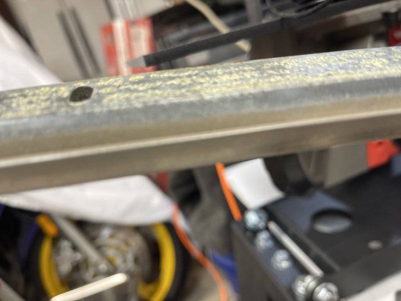

My drip rail is stamped or extruded but has a polished lip and I assume its stainless but heck I don’t know.
I have no idea what compound you used. But I have never cleaned my wheel or really worried about what I use with the goal to clean **** up. I did work and work a bit much and got past the chrome on my original hood scoop bezels, but they still looked good.
and not all chromes are the same; some scratch easily. I wash with a soft brush to remove the dirt, then go over it lightly with a cotton cloth and a car wax, just coating it, not polishing yet. The idea is to remove the rest of the dirt with the wax. I like Meguiar's Carnauba. With 0000 steel wool, I polish a little spot and hold it to the light so see if I'm getting scratches. Some platings will stand up to steel wool, some won't, but wax soaked steel wool speeds things up. On expensive pieces, I use elbow grease with a cotton cloth to make a good finish safely. I'm self taught, so there may be other methods. I haven't polished with power and polishing rouge.
Your drip rail is stainless. Feel how heavy it is, and how rigid it is. Aluminum is not like that.
