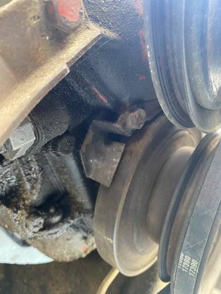

Builder in town is freshening a 318 Poly.
Says there are no timing marks on the timing cover.
The place he’s building the motor for has a spare poly sitting around…….. no timing marks on that one either.
Are the marks on some bracket that gets bolted to the front of the engine?
Pics would be appreciated.
Yes they use a bolt on tab. Two bolts above the balancer on the water pump. Sorry no photo.
Here ya go...just took this pic for you...
