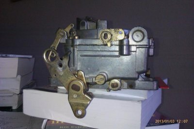

First, it’s missing some of the linkage on the throttle linkage side. It was an aftermarket carb, so it has the universal (Chevy?) linkage. The throttle linkage is there, but the rest is not. I wasn’t sure what the missing bits were for, but searching the web, it seems it’s either a secondary lockout or fast idle linkage, or both. My understanding is that the secondary lockout is just to prevent the secondaries from opening while the choke is on. Doesn’t seem like I absolutely need that since I won’t be flooring it while it’s cold. What about fast idle? If I tune the engine well, do I really need that? There’s a pic below to show what’s missing.
My next question, assuming I use the carb, is what jets, metering rods and metering rod piston springs would you recommend for a stock 318 Poly? This carb was on a 440 so it’s possible it was tuned to that engine and those pieces were changed out. IMAG0239.jpg

I swear I think that Holley will do you a better job. Truthfully, I am not a fan of the Edelcrap/Carter style carburetors.....however, I am not biased enough that I would not tell you if I thought the Eddy would do a better job. I just don't think it will.
personally, i like both holley and carter carbs; but they can be different animals doing the same thing. i don't get lost in the cfm ratings. most of them are over rated and i don't believe in picking a carb by cfm only. if you you think in terms of venturi area the holley is actually smaller. it gets it's extra flow from a better shaped entry. both carbs have velocity controlled secondaries so neither should be torque killers. the manifold is a torque killer. all weiand single four and dual fours that i've seen are single plane. either carb will work. if you use the carter just go back to the factory baseline jetting. i do think the holley will make a little more mid-range torque due to its smaller venturi area and the secondaries opening rate can be tuned.
