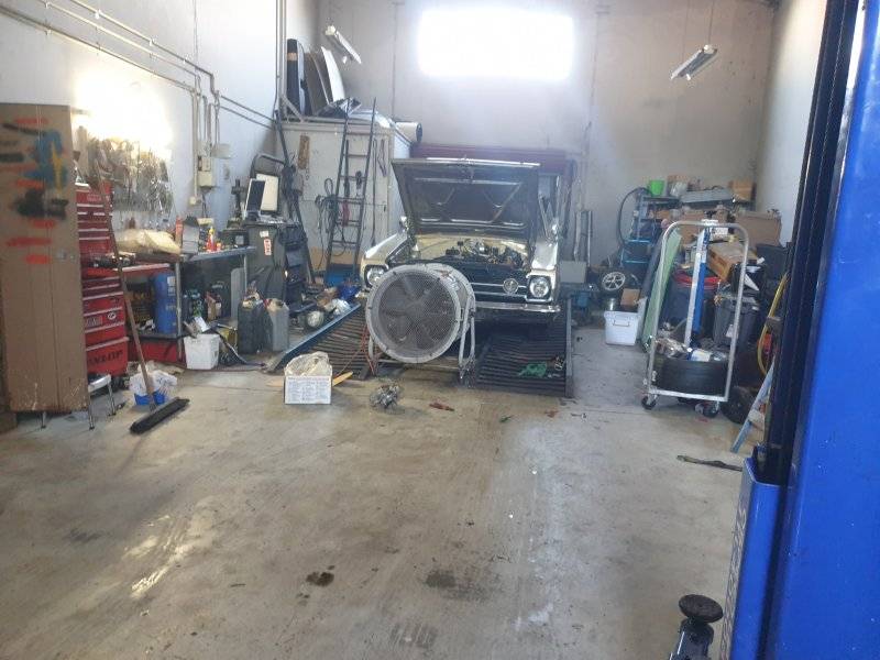

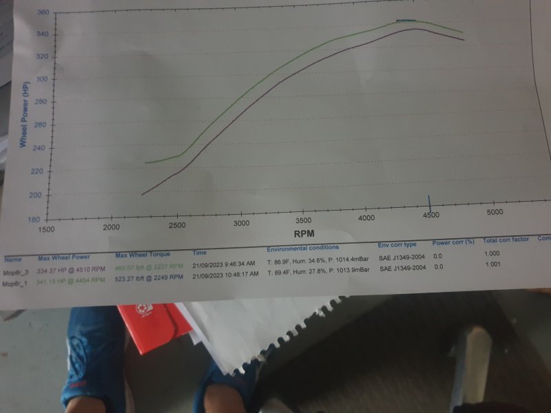

I took my car to the tuning guy today and he put it on the chassis dyno to optimize it and see the difference between the 600 v/s Holley and the 700cfm Double Pumper I also have.
It's a 354 poly, 727 and made 341hp at the wheels with the 700 cfm and 334hp at the wheels with the 600. It was a filthy hot day, 90° by 11am and nearly 100° by lunchtime.
He was very impressed - said it was a really stout engine, the factory 4 barrel manifold is holding it back in his opinion. He didn't really make many changes as it was running great as it was. I was happy with the result but also a little bit disappointed as I was hoping he would find some magic horsepower gain.
For reference the stock 428 Cobra Jet Mustang he ran on there earlier this morning made 290hp. That was an auto too.
I was surprised the power started tailing off by 4,500rpm, I'll have to ask him about that, maybe needs a bigger cam?

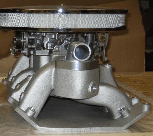

I think your statement on the intake is spot on. Are the good aluminum intakes still available? Pricy but, I would think worth significant HP.

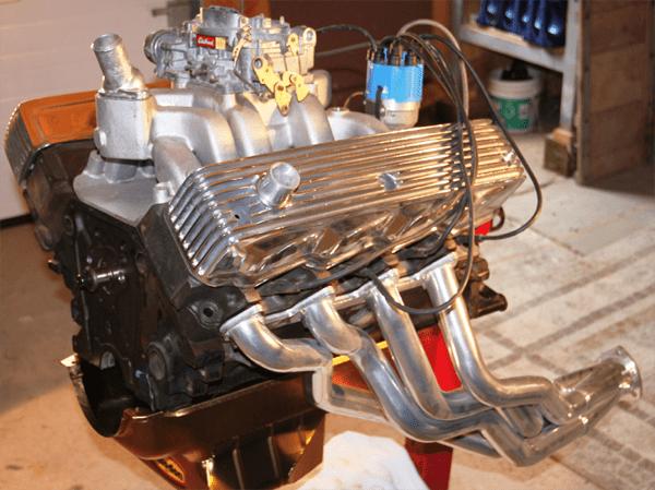

It's a 318 poly with a 3.58" Scat forged crank, Scat rods, Ross pistons 0.065 over, 10.8:1 compression. Poly heads with a little bit of porting, 1.94"/1.60" valves, Schneider solid lifter cam 264F (220° at .050, 0.450 lift). Topped off with a factory cast iron intake and an 1850 Holley 600. It's got headers, stepped from 1 5/8 to 1 3/4, 2.5" dual system.

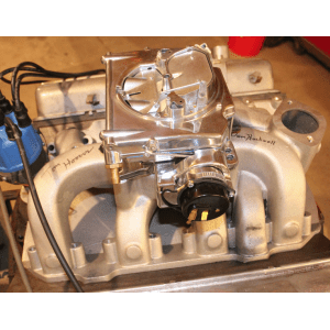

wonder what an airgap and a 4 hole tapered 1 in spacer would do for it.

Chrysler Power Polysuperpac made Air Gap style manifolds a few years back. THey were pretty good manifolds from what I hear. THink about the runner lay out of a LA airgap and the difference in the Poly lay out.

thats the thing with them strait shot ... with them being a cross flow head i don't know why thay shouldn't be able to make a lot of power. looking at the pic ya have here makes me wonder if a single plane would work better. but from what i have been reading .. 4.50 is about the max lift without cutting the pistons to clear the intake valve.

It depends on how radical the cam is. I need to dig my Weiand out and take a look. Some say it's a single plane and looses low end torque.
