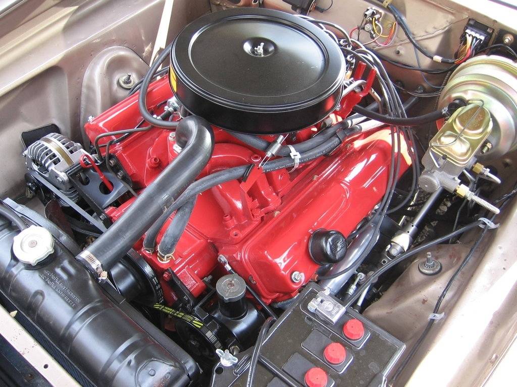

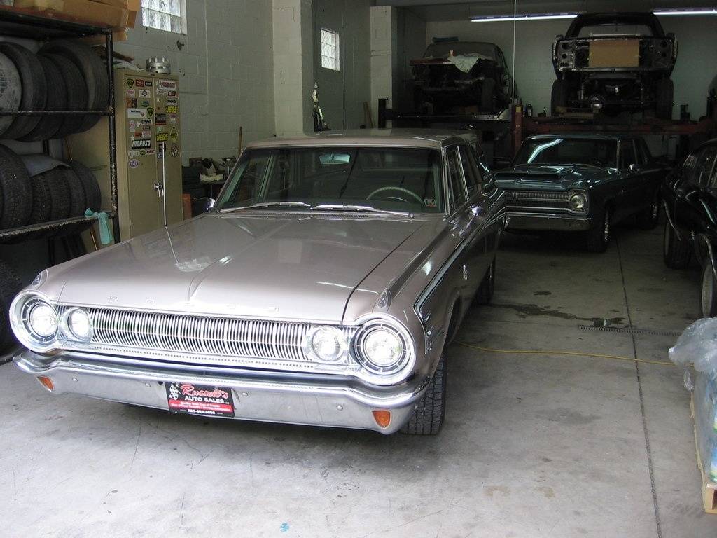

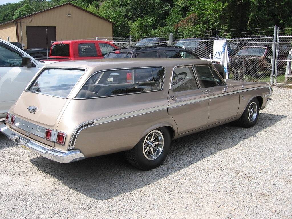

This poly 318 has been stroked and poked and now is at 390 CID. The Chrysler Power Wind Tunnel intake, 650 Edelbrock AVS, a hotter solid cam with a full TTI header and exhaust kit rounds out the package.3.23 gears spin the rear tires and does it with ease.I was very impressed with the performance in this 64 Dodge wagon.Easy can take on and out power a strong 383 and hang with a 440. Sorry for the crappy photos as it was about to rain. I wanted to take it to a park and do a photo shoot but I was lucky I got what I got.Enjoy !

Darter6, Could you give a few more details on the internals of the engine? I've got a spare poly going to a machine/engine builder shop tomorrow. To get a clean up and assessment of the engine. Been thinking 350 cu in range because mine is a daily driver and regular street 'n strip racer. Maybe I see a 390 in the near future.

I was visiting folks back east and the car isn't mine. I 'm not sure if a kit was used but I do believe everything came from POLYSUPERPAC.COM out of Texas

The company I posted can help you. All components can be bought on a individual basis. I went back east for Carlisle last month and we drove it from Pittsburgh to the show.About a 3 hour drive give or take. I am very impressed at how nice that car is.Owner said plans are to do A/C soon.
