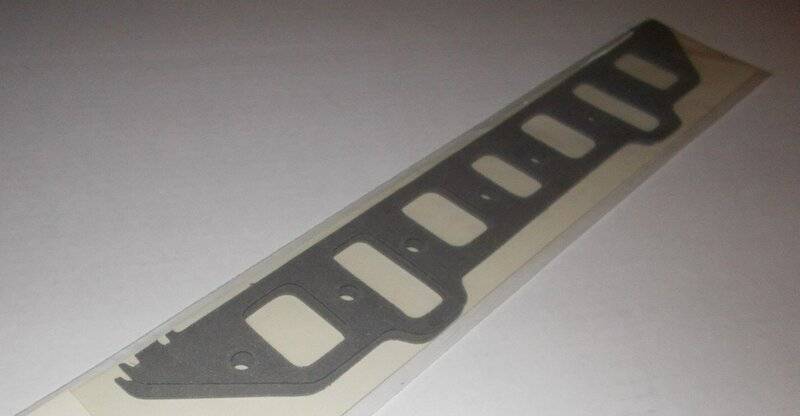

The only aftermarket intake was a Weiand and they use stock gaskets. If you’re using the metal intake gasket, try the thicker fiber gasket. I closed off the heat passage through the manifold with metal plates and had to use the thicker gasket.
Thanks for the responses . Are the gaskets differant than those of the later 318 heads ?

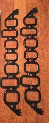

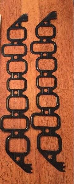

318A Poly heads are different than the later 318LA wedge heads so the gaskets are different. Here are both the metal and fiber gaskets. I believe Felpro makes both but can't remember where my fiber ones came from. Also, throw away the foam end seals and use a generous bead of RTV for the front and rear seals. The foam squeeze down poorly and sometimes causes a gap between and block and manifold especially in the corners.
