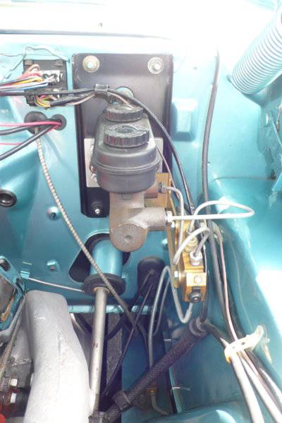

Hello all,
Been awhile since I've been on here! As some of you may remember, I have a '64 Polara that was pretty much a basket case when I got it. Most of the big issues have been worked out for now, but the one I'm having a hell of a time figuring out is the brakes.
Here's the scoop. It's got manual four wheel drum brakes. The master cylinder has been converted from the original single pot style to the dual chamber style. Every part is brand new. The issue is, the car doesn't stop for crap. I'm not saying it takes 500 feet to go from 80-0 mph. I'm saying it takes 5 miles to come to a stop. The pedal is firm as rock, but seems to "grab" low (about mid travel). Here's what's been done so far:
- As stated before, new master(s). Initially I tried a MC from a '76 Dart that also has four wheel manual drum brakes. Pedal grabbed low. Currently have a master on it from a late 60's Monaco or Charger on it. No change. This swap was done to test and see if different bore sizes (15/16" vs 1") would affect it. Both masters feel identical in the car.
- New brake lines front to rear. Line off front of resivoir goes straight to the rear brakes. Line off the rear resivoir goes to a junction block that splits to go to the front brakes. All brake lines on the car are 3/16" diameter.
- New wheel cylinders, shoes and hardware (including adjusters!) at all four corners. New drums in the back. Front drums were turned so there's no ridges in them. Shoes are oriented properly withing the drums as well. All brakes have been adjusted up to the point they *just* touch the drums and lightly drag while rotating. For shits and grins I have also run the shoes tight up to the drums and pressed the pedal. You guessed it, no change.
- I have bled the brakes three or four times at least. I always start by gravity bleeding them, then doing the two man bleeding procedure. The fluid streams at the rear of the car aren't as strong as I'd expect them to be (weaker than the front anyway). They just kind of dribble or lightly squirt when the bleeder is cracked. I am running new DOT3 fluid.
- I have tried lengthening and shortening the brake push rod to see if that changes anything, but it doesn't.
The pedal *grabs* at about half stroke. At that point it becomes solid as a rock or dang close. When driving down the road if I slam on the brakes it will not lock any of the wheels, no matter what speed I'm at. Even on gravel, it will not lock the wheels up. When the car does finally stop, it stops surpringly straight about 75% of the time.
I'm not new to Mopars or drum brakes at all. My first Mopar ('76 Dart) had four wheel manual drum brakes. That pedal was high and very firm. That car had no problem stopping at all! I also had a '72 D150 with four wheel power drum brakes. It also stopped pretty well.
So I'm a bit stumped here. Do I need a proportioning valve? A large parachute? A different master? I'm out of ideas!

I like the look of that junction block. Certainly keeps everything nice and clean! My setup is identical to that, just without that exact block.
I saw a way around the block somewhere when converting from a single to a dual MC. Probably what you did and I'm thinking it's ok.
- If the block works the way I think it does, I'm pretty sure they do the same thing. One just looks prettier!

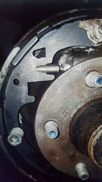

I think you have a friction problem. Can you find a shop that can grind your linings to match the radius of your drums? I did this on every brake job I did when working in a dealership back in the early 70's (before asbestos was known to cause cancer)! Always had good brakes. A different lining material also may solve your troubles.

If you pull your rear drum off you can see how much of the shoe is hitting the drum. That will tell you a big story. If the shoes have not been cut to the drum or fitted you my not be using the brake shoes completely. I have seen up to 1/4 shoes not being used because of the arch in the brake shoes causing poor brakes. But I would in your case look for a blockage. Just 2 cents worth.

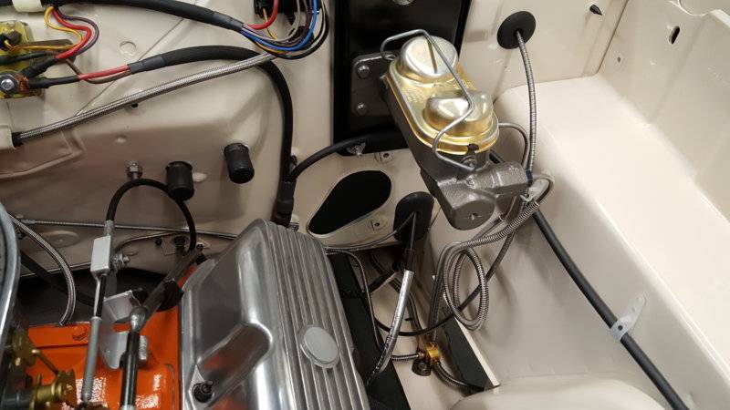

Here is a pic of the MC set up in my 64 when I converted it to manual disc brakes.

I've gone through the same problem with my '65 Coronet with drums all around. I recently took off the drums and found that they were glazing. Was it the new material stuff or just air in the system? I don't know but I decided to go back to the original organic shoes to see if there was a difference. I am going to take the car out soon to break them in and test and then I'll get back to y'all.
If you cannot find nos brake shoes the drums will glaze and it will never stop.
This is my personal experience.
My 64, all new brakes, stopped great then not at all.
Pulled the drums, took some rough sandpaper and sanded at an angle one direction, then the other.
Put it back together and it stopped fine, for a few days.

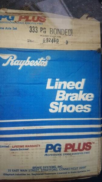

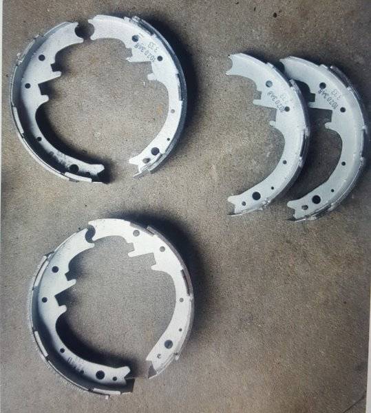

Are you saying now that the car stops good because of a set of old school organic brake linings installed?
I bought new organic brake shoes, they sucked.
I found pics I took, the nos ones are Raybestos, the box states asbestos free, but not sure if they are organic or not. My guess is semi-metallic.
The last pic are semi-metallic I bought from summit which are for a 65. Similar, but not the same, specifically the upper spring hole isn't round, and it's not as far back.
I tried those on the front, and with a different spring one side worked, and the other side would not no matter what I tried.
Wasn't sure if the 65 backing plates are different from 64, I was going to order a 65 spring/hardware kit, then I found the nos shoes.
