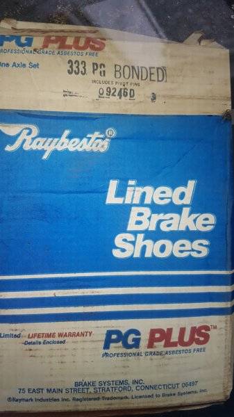

So just too reiterate, you're saying that your car now stops better with the Raybestos NOS liners correct?I bought new organic brake shoes, they sucked.

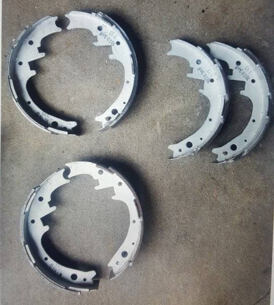

I found pics I took, the nos ones are Raybestos, the box states asbestos free, but not sure if they are organic or not. My guess is semi-metallic.
The last pic are semi-metallic I bought from summit which are for a 65. Similar, but not the same, specifically the upper spring hole isn't round, and it's not as far back.
I tried those on the front, and with a different spring one side worked, and the other side would not no matter what I tried.
Wasn't sure if the 65 backing plates are different from 64, I was going to order a 65 spring/hardware kit, then I found the nos shoes.
View attachment 891178 View attachment 891179 View attachment 891180
The brake shoes with the upper spring square hole are for the '69 and up models and I believe for the rears only. I could be wrong. My friend "Special K" knows all about these things. They will not work with the return/tension spring supplied for the early 60's round hole style. A longer spring can be used but for one sided as you mentioned.
