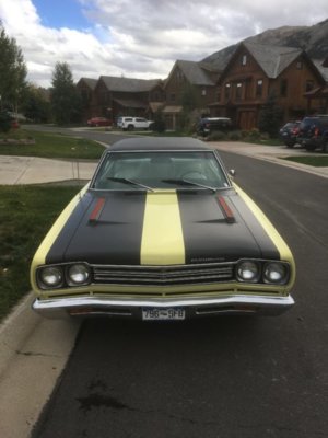

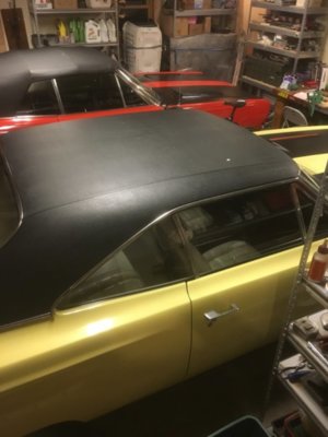

Hi, my name is Beckett and I just signed up because I need a little advice. Owned several mopars over the years. Currently have two Roadrunners, hard top and a rag top. Currently having issues with the hardtop. Ran perfectly, then went on 250 mile round trip. It developed poor idle, hard start, then would die after 5 minutes. Checked carburetor, fuel filter. Possibly vacuum advance, points? Why will it run for 5 minutes then die?
