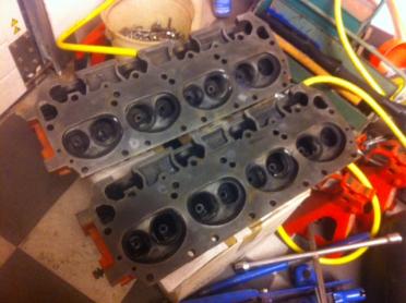

Got a set of 516 and a torker intake that is far from perfect when it comes to port match, is it worth the time to make them match or shall I leave it as it is?
Power gain 10-15 hp?

Port matching is definitely worth the minimal effort if you have the die grinder & proper carbide bit. Match the gasket, being sure to bolt up the intake first, & use a bent coat hanger to see & feel the areas to grind. Lots more power is available by opening the area under the valve seats, "pocket porting". Start with small changes while being VERY CAREFUL.

From what I know the roof and sides are probably the most important areas to match but really should ask IQ52 since he has a flow bench. 10-15 HP? Maybe at max RPM but not counting on it.
Think of steps. Easy to fall down them than it is to go up them. If the port mismatch is going down a step, that's not nearly as bad as the fuel/air charge trying to flow up over a step. And air is more forgiving than the fuel is. Bad ports will make the fuel charge want to separate out of the air stream. Do the heads have any port work done to them? The bowl just under the valve is pretty crappy from the factory and it needs attention if you want any kind of an increase in performance from them. If you port match without at least working on the bowls, you probably won't see much improvement if any.
Thanks for all the help, I spent a couple of hours working on the heads, damn it was a dirty job!

I forgot to ask, what size valves in the 516's? I ported a couple sets of those for friends with real god results. They used stock 2.08/1.74 hp size at the time.
My 516 has the 2.08/1.74 setup, pretty tight in the guides too, will just grind in the cleaned valves, throw in new seals and put them back together.
