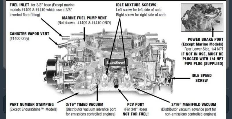

So every always wants to get into the debate of ported vs manifold vacuum advance. I talked at length w the owner of 4 Seconds Flat. He made total sense. The ported is for cars that had some sort of computer control/smog control. Manifold is for those that do not. It is a lot to go into, but actually very simple. But for further proof, here is the definitive from a much respected source. Edelbrock!!!

Hmmmm, then I guess the "engineers" at Edelbrock are crazy also. I did not email him, rather a long in depth conversation about it. I was of the mind that it must be Ported also. After listening to his reasoning, not ramblings, it made total sense. And apparently Edelbrock, Holley engineers tend to agree.

I agree with Edelbock. A proper manifold vacuum advance system will improve idle quality, help your engine run cooler, if it’s of any importance to you - improve gas mileage and doesn’t affect street performance in the least. Ported vacuum advance was a aberration of frustrated emissions engineers staggering around in a dark world.
