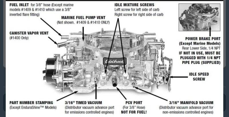

So every always wants to get into the debate of ported vs manifold vacuum advance. I talked at length w the owner of 4 Seconds Flat. He made total sense. The ported is for cars that had some sort of computer control/smog control. Manifold is for those that do not. It is a lot to go into, but actually very simple. But for further proof, here is the definitive from a much respected source. Edelbrock!!! View attachment 1069631

Ported means there is little to no vacuum signal at and just off idle. Its purpose is to maintain initial distributor timing at idle without any additional advance because it's not needed. Once rpm increases ported vacuum begins to advance the timing via the vacuum advance (the mechanical during wide open throttle). It also gives you more advance than mechanical when your at cruising rpm for fuel mileage. Manifold vacuum is normally high at idle which will add distributor advance at idle which you dont need.
Obviously, manifold vacuum is obtained from a port accessing the intake manifold vacuum signal, and subjecting the vacuum advance appropriately. As noted above, ported vacuum refers to a port that is located in the carburetor venturi just above the throttle plate, so at idle, the port is basically exposed/accessing atmospheric pressure. As you open up the throttle, the throttle plate edge moves upwards, passing the ported vacuum port, which now subjects the port to the manifold vacuum (pressure) which would be a lot lower than atmospheric, now creating a vacuum signal , and now advancing the timing. From my understanding, this was done as early/easy emission control, as delaying the timing at an idle delays the combustion process such that combustion is taking place a lot later, after TDC. Because of this, the "burn/expansion" is not as efficient, and the combustion gases and exhaust gases remain hotter to lower emissions/unburnt fuel. The increased temperature will also transfer more heat energy to the cooling system of the car, as both the temperature is greater, and you're burning more fuel to maintain the engine at that same idle speed. I'm guessing you'll have to open up the throttle plates to a greater degree now to maintain the same idle speed.
