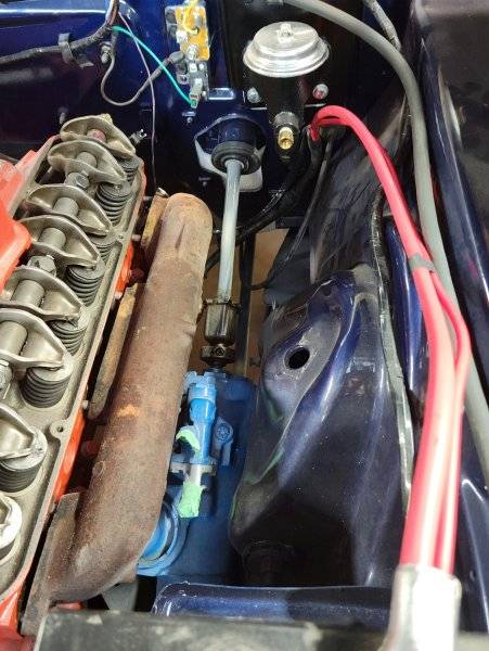

Hey all,
I replaced my 318 with a 440 and bought a replacement pos. batt harness from Classic Industries for the 440. Anyone have a picture of how the cable routes past the exhaust? I know it's close but I want to make sure I am routing it the correct (factory) way.
Thanks in advance...
Looks like a 66. And the starter relay is upside down.
Factory had a clamp on the fender apron for holding the wires
Well spotted... it is a 66 but 440's didn't come to the Charger line till 67 so I didn't want folks saying "66's didn't have 440". Thanks for the relay tip. I could not remember how it went originally. I have the plastic fender clips for the cabling. What about how the cable drops down around the steering column... does the main lead go under or over the column?
BTW... how could you tell it was a 66? I didn't think there was much difference inside the engine compartment between 66 and 67???

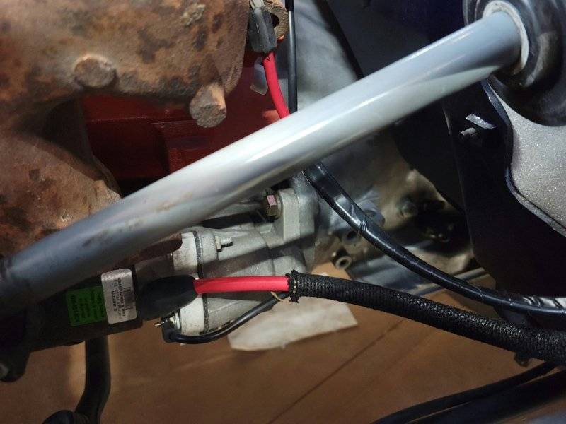

cable goes under the column , behind the exhaust pipe

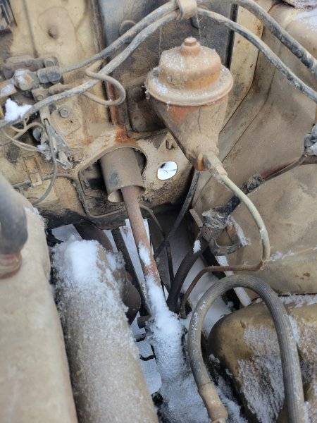

UPDATE, I was in the garage the other day and saw my yellow car has the 2 clips on the inner fender ( not the one on the frame rail. ) My hemi car has non of the clips on it.

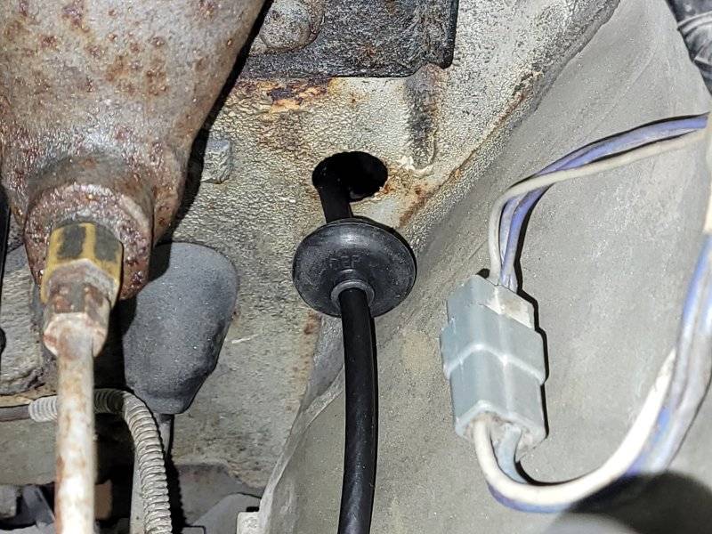

My HP2 has one for the battery cable. I'm currently running a new speedometer cable through the correct hole and noted the lack of a speedo cable clip, but definitely no hole for one.
