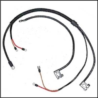

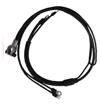

Need to replace the positive cable on the 65 Coronet. Original is cut up. What one is original? I'm thinking the flag style terminal is? .... $$. Will any BB cable work ... I see some for 69-73 going for as little as $33.
In my experience, the cable on the left is what the original looked like.
The cheaper cables use aluminum which will quickly heat up and cause issues. If you read the description of the cheaper cables by some of the vendors selling them, they will even make a note to not use the cable with the high amperage starters as the cables not stand the heat generated.
The cables that we provide are based off of assembly line pieces to duplicate the various colors and head styles. Over the counter NOS parts have been found to differ from the assembly line pieces. All of the cables that we offer feature the correct gage copper wires, lead heads and plated brass terminals just like the factory pieces. Depending upon the vendor of your choice, these cables typically sell in the $125 to $150 range for the positive cable.
