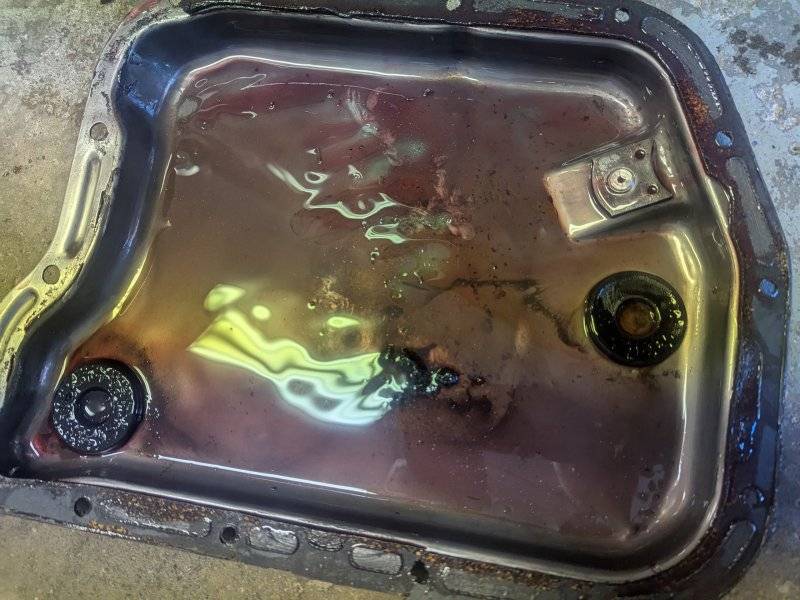

Soo.. trans is ready to drop... pretty much just have to do the bellhousing bolts, but i want to do the valve body stuff first so i don't need to flip the trans around on a bench and make a mess.. pulled the pan and i have a bit of glitter and black slime which has no abrasiveness and i assume is clutch material? more glitter than i would like.. but not sure at what point to worry... I talked to Cope last year and he told me to expect some glitter in a fresh build no matter what...

This is after about 70 miles.. and a questionable converter.. but a lot of my glitter looks like brass so i don't think it's converter bits.. at least the fluid was nice and pink and no chunks in the pan.
Brass could be from the converter as the fins are furnace brazed.
