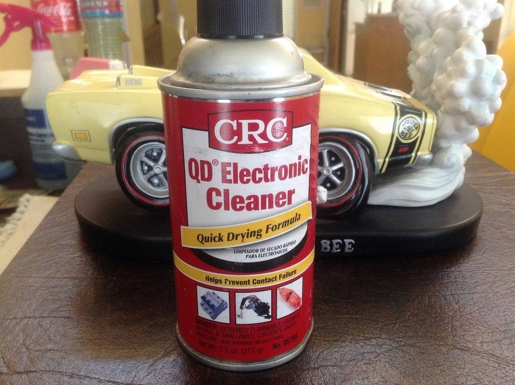

Bulkhead. This is what I use. Just keep spraying until it runs clean. Mine was filthy, probably never off before. Gently squeeze the tabs and have a small straight screw driver handy to coax. Just don't break anything. Use a fender cover and take your time.
How bout the use of dielectric grease when everything is clean and plugged back together?
Agreed. I put it back together without doing that and fear breaking something if removed again.
Don't want to mess with success - for now. Any future will include dialectic to finish. Car has not had a hiccup since cleaning the connectors at the bulkhead.
