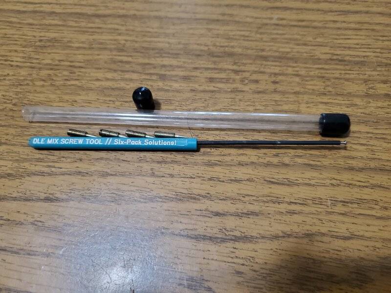

I have a setup provided by six pack solutions, I believe he is no longer selling this.
This was replacement mixture screw set that have a hex (allen) head and a tool that has a rounded head.
This easily reaches the rear carb mixture screws and works like a charm, I replaced the front also to make that even easier.
Pic shows all my original mixture screws.
Someone needs to start making this again!
