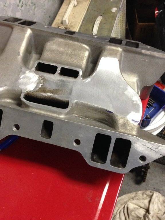

I agree with most of these tuning do's & don'ts except for blocking off the heat crossovers. If the choke is properly adjusted there should be no issue with crossover heat except for burning off the paint. For me, it is a right of passage. Ma designed them in for a reason and I believe some things are better left alone.
Some interesting thoughts on this one... hmm, I can only get mine to run 10's in street trim..? Gotta be doing something wrong..:realcrazy:
Heat crossover good for an everyday driver. Blocked for a cooler intake & more HP.
Anyone verified the difference in HP? I can't believe it could amount to enough to offset the driveability.
I know I haven't. But I know that when Ma Par designed it's most powerful wedge motors, they didn't have heat crossovers. True, if it's cold, you can't just start the motor and drive away if the crossover is blocked. If that's the type of driveability you expect, keep the crossover.
