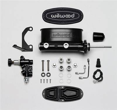

the one thing about the wildwood set up to me is
I hate the way that master cover looks
I would be putting black tape over that lid. lol

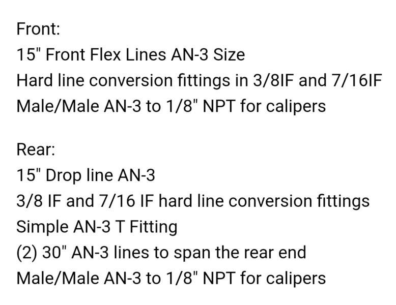

The fittings/adapters are being supplied by the Wilwood vendor, and I showed that on the inventory list.
@5.7 hemi
Take a look, I think this covers what you suggested as far as SS braided lines and adapters goes:
Can anyone tell me if the rear end block breather hose part (that I just replaced in October) is part of my future arrangement? If so, what does it do exactly? It looks like they are providing a T fitting, and I'm not sure how that may tie into or affect the hose/breather/block thing I bought.
