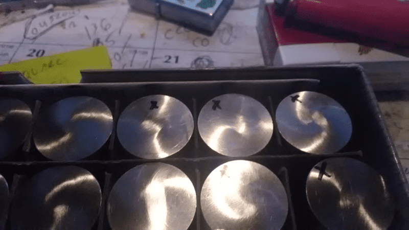

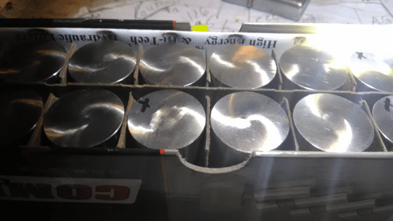

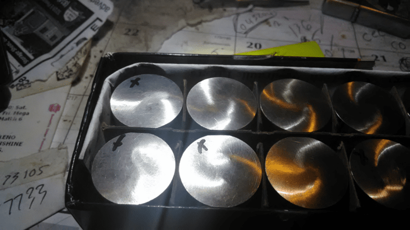

ok .... just a FYI ... here is a set of NEW comp cams 822 hydro lifters...
pic #1 as you can see there is NO swirls on the face and is flat..... #2 has come pre flat with a dish in the face of it .... #3 has 2 dips in the face and no swirl marks ...
these are what is coming out. only 6 had a taper of 1-1.5k needed to make them work as thay should.

Junk. The ones without a crown won't turn in the bores and will wipe out a lobe.
at this point it don't matter who or where thay came from to sell us. no way in hell this should have been shipped out to a builder.
i sent them these pics ... as of yet have got no reply
They don't seem to care
