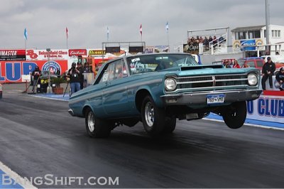

65 belvedere /427sbm
As i am a newbe, i'm trying to get my mopar photos on to this site, i did get them attached to my " new member" site.
I am the 2nd owner of this all-steel, all motor smallblock bracket car. It was originally a 273 904.
The 69 charger 500 se has a 487 inch hemi, boyd 16" rims, wilwood 4-wheel discs, 3.70 gear, 4,500 converter. Full tti exhaust and just this way on crap b.f. T-a radials (closed exhaust) ran 12.32 @ 117 m.p.h. At kearney ne. ( 2.12 et 60 foot !)
thank you everyone for your advice on helping! Many of the terms used in computer lingo i don't understand, but still trying.
