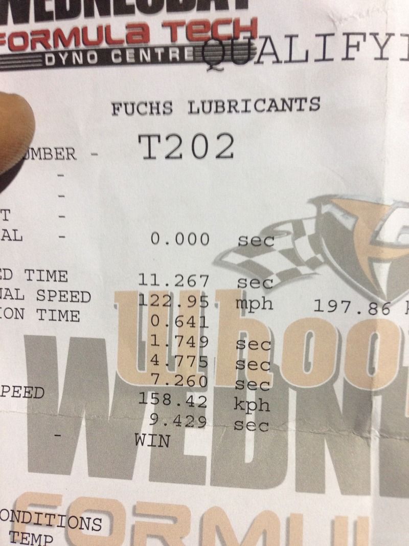

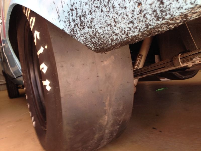

Here is the 440 VG Valiant of my sons, I ran it on full street rubber last Wednesday to 11.26 @ 122.95, this Wednesday it's on some 26x9 Hoosiers so expecting a 10 with the young gun driving.
Yea 122 mph should get you in the 10's with good hook. Good luck , Ron

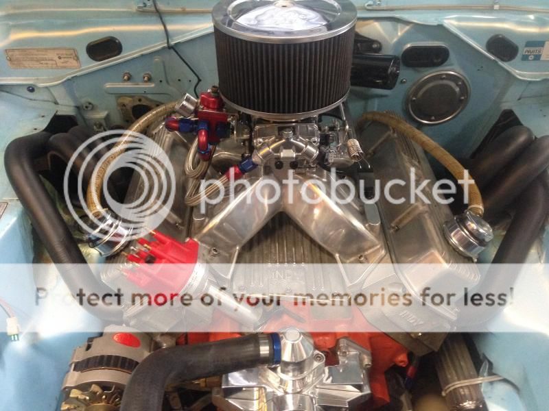

Ran my Barracuda on Sunday, getting off the pedal at half track as I was limited to 12.00 due to no cage or harness but the plan was to go out the back door when I was ready and go home :) First card is 11 half track and the second is the one that was going to be it but I stuffed it and left in second gear, as you can see from the half track et it would be .4 better than the 10.60. Anyway I still got told to piss off so did not get another chance.
The car, 71 Barracuda 528, Indy top, roller cam and dominator carb.
Well it's ON !! they have allowed me to show up on a Wednesday Night so it's is happening this Wednesday. We are coming into our winter and it is starting to get cold, altitude air density was at +1400' on these time cards but it will be around -500' this week. We have added bigger jets and the plan is a few half tracks and then all the way without any stuff ups . Im not going to say NINE yet.

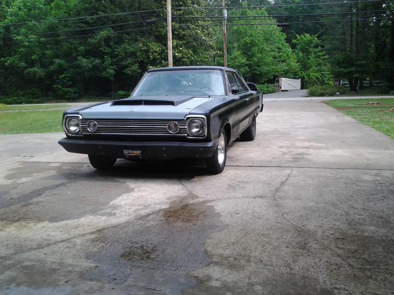

Well i am following this thread closely i will be building a stroker motor soon i hope... But for now this is my combo and i have a fibergalss hood & scoop & fiberglass Bumpers front & rear i have also taken weight out of the car like Aluminum parts on the engine and there is no wiper motor or heater box anymore no back seat at all car has a fuel cell...
My motor is a 440 bored .040 over keith black pistons stock crank & stock rods i opened up oiling for better flow ARP bolts used on all the major areas the entire rotating assembly was balanced i am running a Mopar 312/590 cam & lifters a holley 950 carb & M-1 Intake port matched to my Indy Sr Heads that have mild port work done they flow 334.5 @ 700 MSD Dist & Box headers are TTI Step Headers 2" into 2 1/8 Tubes into 3 1/2 collectors into Dynomax Super Turbos.
Trans is a very well built 727 with racing clutches & Bands aftermarket 727 BILLET REAR SERVO KIT & BILLET ALUMINUM ACCUMULATORS with a CRT-22 Reverse Manual valves body & deep pan stall is a 4500 rearend is a 8 3/4 with 3:91 gears SS Springs & Long Drag shocks & a Pinion Snubber.
I do have a set of 4:30 Gears i want to change out.
Tires and rims are Center lines up front on radials tires 165/80/15 Rear tires & rims are steelies 15x7 i am running Mickey Thompson Drag Radials 275/60/15
I hope i can reach what you all have done & be Consistent..

Let me say that is a sexy 66 man I love these belvederes, Mine is a 67. You should be in the tens all day man honestly with those heads flowing like they are it has alot more potential. My heads only flow 301 at .600" and they stay the same up to .800" I am sure you are like every one else that has a budget because it is so expensive. But that combo with a 1150 dominator should run its but off man not saying the 950 wont either though. You should def be in the tens but the question is how far? lol Good luck man itll be worth it in the end

thanks Mike it came out pretty good. Wrapped it in flat black... Been working on this since fall of last year. Just finished it last week. Had a girl wrap it in Roseville Ca. It took her a couple of days in the mean time I painted out the front end and the grill and the glass bumpers. I really think its way more aero now. and I can see better than with that big scoop. ( not that it helps me cut a better light)
