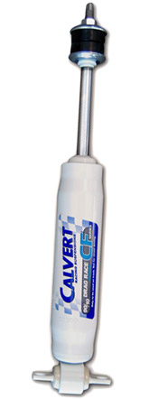

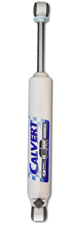

Steve Good luck, Jim & Cody LaRoy, ala LaRoys Engines out of Challis Idaho :headbang: , will give you a great engine combo, if you listen & do what they say... You should be in the 11's pretty easily, you have a great base, maybe add either S/S springs & adj. pinion snubber or Calvert/CalTracs could get there with decent traction & properly tuned engine/chassis & tire/Converter {maybe more converter too, 2500 is kind of low stall speed for any 10 or 11 second car, 3500-3800 would work much better}... The intake & carburetor combo maybe could also be improved some also, squirter's accel.pumps cams air bleed, metering blocks, jet extensions on the rear, trim air horn, etc. lots of places/part to tune/tinker with... Take weight out of the car where ever you can, power to weight ratio is the whole deal sometimes, especially with these heavy cars, maybe move the battery to the pass. side rear trunk, add some adjustable, front & rear drag shocks, larger sending unit 3/8" min. & fuel lines 3/8"/or #6AN min, adequate fuel pump, that will work fine on the street or track, help to achieve the 11 second ET goals....

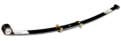

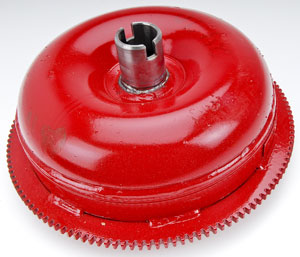

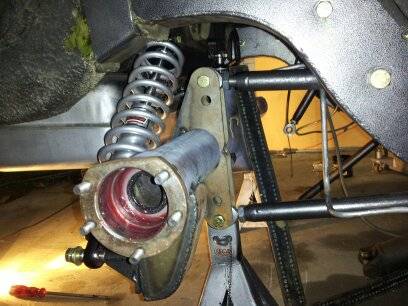

68 charger
tubular k member Qa1 adjustables all round and wilwood big brakes
4 link rear, subframes
2800lbs
440 .30 over
4.25 stroke -----505 stroker
12.5 to 1 comp. flat top 4.5cc pistons
80 cc ported stealth heads 1.5 rollers
edelbrock dual quad 2 x edelbrock 500 cfm
lunati hyd flat tappet Advertised Duration 300/305
Duration @ .050 250/255
98 octane pump gas
msd 6 al 9mm wires
billet flywheel
kevlar clutch, 18 spline a833 with OD and custom rods
489 8 3/4 detroit true trac 3:55 gears
27" tires 305 wide
anyone got a similiar combo?

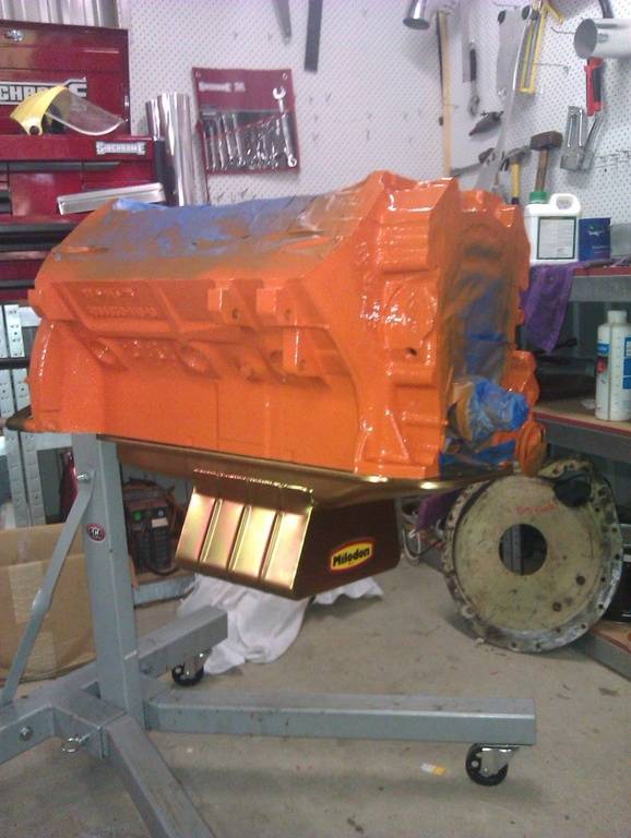

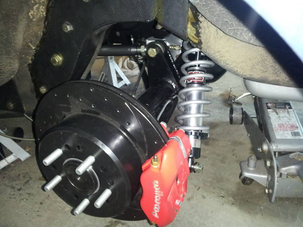

Any photos of the beast...

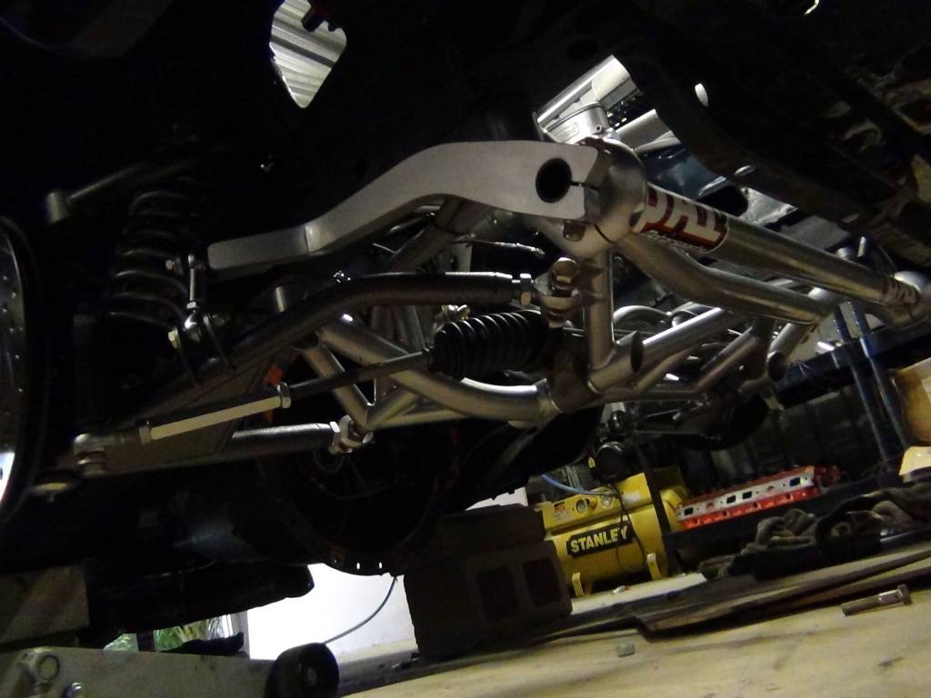

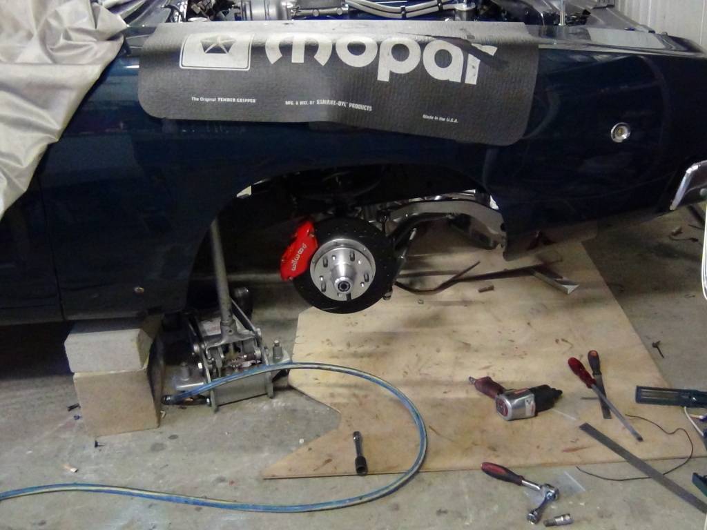

yeh i am really digging the magnumforce suspension, looks great as well, the 27" 305's are street/strip tires, like i said the
car is not yet complete. only things i am waiting on is to put the engine back together which got back from machining last week and the new wheels to come from the states, but i do have pics of the car before and after the suspension mods etc.

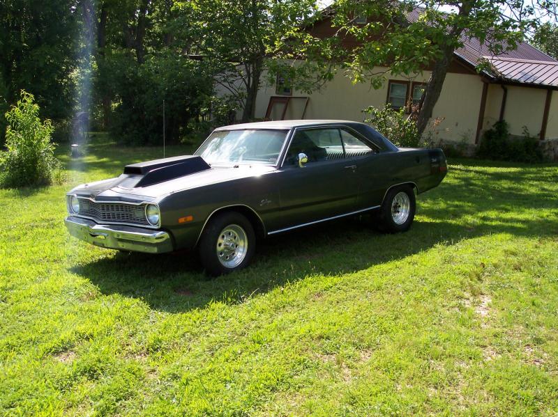

My car is a all steel 1973 dodge dart that weighs 3520 with me in it. heck my old 65 hard top Plymouth Belv II with a 10 point cage only weighed 3460 with me in it.I have not installed a cage my my dart yet. any way here is all my info
1973 Dodge dart that is race on 93 pump gas and will be on the street next year
1973 0.030 over 440
wisco pro-true flat top pistons, about 0.006 in the hole
Compression is around 10.9-11.1
felpro pT 8519 head gaskets
cranking compression is 184 psi
Eagle H-beam rods
Stock stroke steel crank
Comp solid roller 264 at 0.050 and 595 lift/ 634 with the 1.6 roller rockers
Crane 1.6 roller rockers
Manton push rods
Mostly out of the standard Indy EZ heads with some very mild bowl porting, soposed to flow around 310-315 at 600 lift
wieand tunnel ram
2 650 Holley Dp converted to 750 with pro form main body's
TTI 2x3-1/2 headers
727 trans with a bunch of CRT parts etc
dynamtic 9.5 4200-4400 stall
8-3/4 742 case with 4.30 gears
M/T 275/60/15 ET Drag radials
With my friend driving the dart here is my best time. but i think there is a lot more in the car. because i have not got a chance to really do any engine etc tuning on the car. OK here goes
60 foot 1.48
1/8 mile 6.70
1/8 mph 101.90
1000 foot 8.74
1000 mph 115.60
1/4 mile 10.49
1/4 mile 124.56
for got to add the carbs are jetted at 72/84 with 6.5 power valves in the front and 36 degrees total timing. i think i can get more top end by adding more jet, but did not have enough jets on me to try it. so what do you guys think?? also my goal in the next couple of years is to get back into my dream car. A 1963 dodge.Thanks Mopar65:headbang:

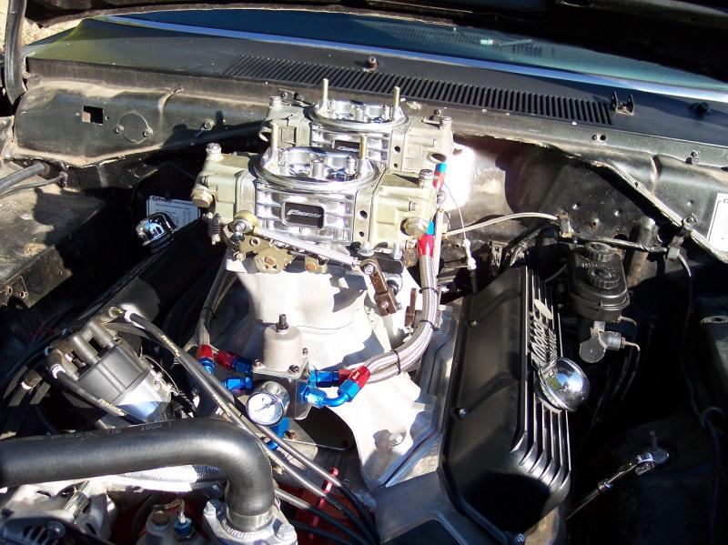

Well my cam is so posed to be a roller version of the mopar 590 solid cam. I would like to try a edelbrock super victor intake and a Holley 1050 dominator. But I spent all the money i had getting the tunnelram all set up and working. another thing i don't like about using the tunnel-ram is you have to run such a tall hood scoop on it.best of luck to you on your nice car. I would love to trade my dart for a early body again.Mopar65
Mopar65 the 73 Dart 440 engine combo sounds great, any photos of the car &/or engine or at the track ??

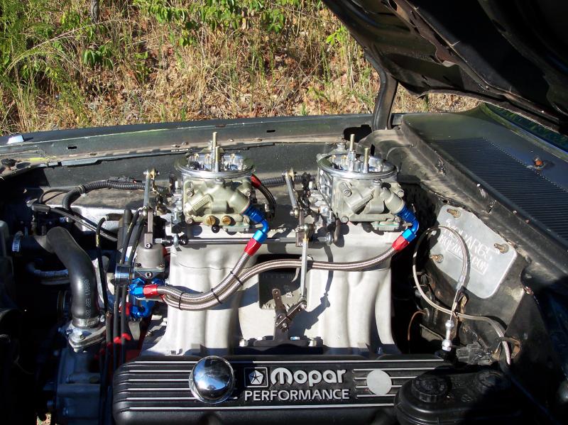

Budnicks thanks for the kind words. i really dont have a good pic of the car at the track, but here are a few of the car you might like. thanks mopar65005 [1600x1200].jpg

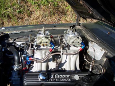

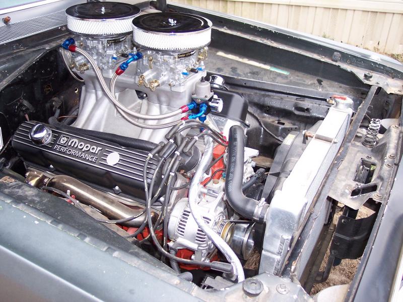

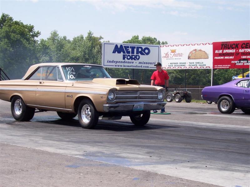

here is a pic of my 65 plymouth that i wish i would of never sold. should of sold the X wife instead.lol 100_0083 (Large).jpg

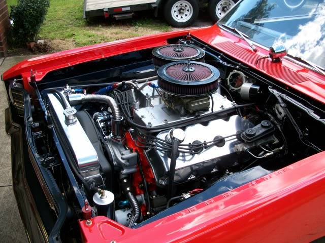

505 CI HEMI machined and built by me
mega block, 4.400 bore 4.150 stroke eagle crank
diamond custom pistons, 10.7:1 1/16 1/16 3/16 moly rings
manly H-beams 6.865 Bob Weight 2627
Schneider Solid Roller custom ground 260/266 .620/.600 @ 112
BMS roller rockers 1.65 intake / 1.6 exhaust
Smith Brothers pushrods
MP Iron Heads, mild hand port and bowl work
MP cross ram, port matched. 2 Holley 770 cross ram carbs
Charlies 10 Quart oil pan w/ milodon single line external swinging pickup
MSD 6AL W/blaster coil
AC R43-XLS plugs (cheap and easily available)
Holley HP150 pump no return/ using stock gas tank
727 built by my Father
alum front drum
A&A valve body
9" J-Converter
Dana 60
Detroit locker
4.56 gears W Strange 35 spline axles
Caltrac's with mono leafs
Rancho adjustable shocks on rear
Calvert 90/10's up front with RMS tubular uppers and strut rods
Car weighs 3780 with a Half tank of gas and my *** in the seat
leaving from idle off foot brake
been 10.34@130. it went 10.34 on the brakes 3rd round when i had it out to norwalk this last sept @ 124. prob had a high 20 in it, the air was killer.

thanks!! its just a fun little street car
Yea and we love little fun street cars as that is one of the finest I have ever seen !
Moparsteve636 thats a very nice 65. Ron
