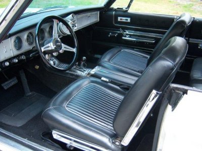

Post your 12 second combos
65' Coronet
3675 lbs. w/driver
440-.30 over
Pistons-TRW flat tops
MP 484 Hydraulic Cam
67 915 Heads- 2.14-1.81 valves
(stock stamped steel rockers)
M1 single plane intake
850 holley DP
TTI Headers
Full 3" exhaust w/crossover and flowmasters
727 Trans. w/reverse manual valve body
9 1/2" converter-3500/3800 stall
8 3/4 rear- 4.30 posi
30" M/T Drag Radials
S/S Rear Springs w/ snubber
90/10 Front Drag Shocks
ET 12.00's @ 111 MPH "All Day On Pump Gas" -"Street Driven Regularly"
Easy high 11's with minor tweaking............

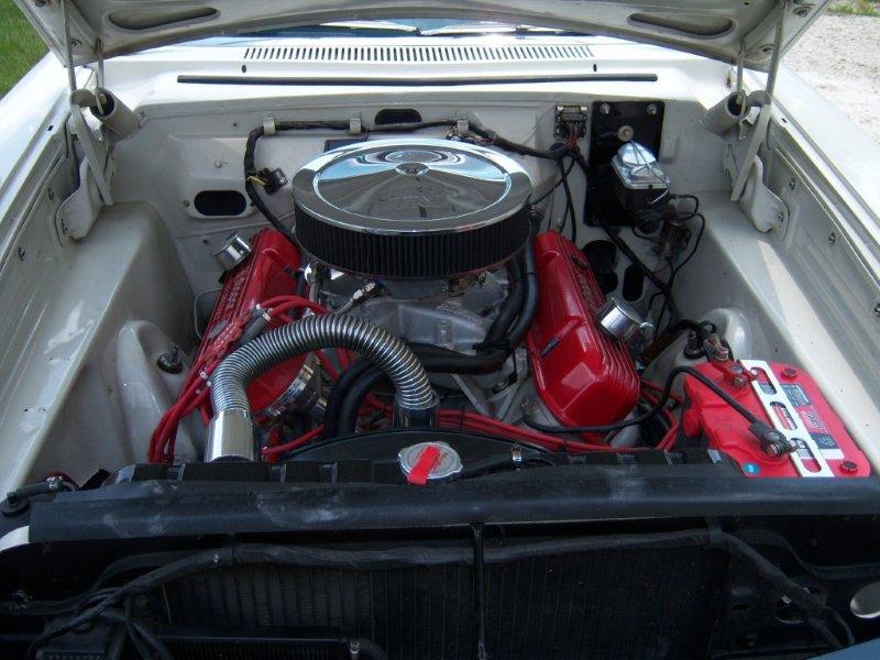

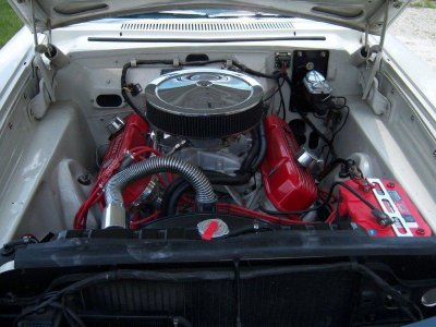

1965 Belvedere I
69 440 .030
KB 184 9.0:1
purple 484 284
stock 906 heads stamped rockers
performer rpm 750 cfm dp
msd dist 6al
727 revrse manual vb
ATD 3500 10 inch
8 3/4 3.91 spool strange ss axles
ss springs and snubber
best et 12.47 @ 107 5500rpm shift point
Looking for info on a camshaft to get this combo into the 11s consistantly, any recomendations?

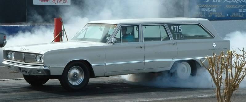

My old wagon I sold in '05.
360 crate motor / 904 / 9.5 Dynamic converter / 4.56 / 12.49 @ 106 best.
Fun, low maintenence, consistent bracket car.
1965 Belvedere I
69 440 .030
KB 184 9.0:1
purple 484 284
msd dist 6al
ATD 3500 10 inch
car weighs 3730 with me in itView attachment 92923
Camshaft swap might not be your best bang for the buck in your case.... I would look at getting into a new set of heads if it were me... Getting that engine to breath will reduce your ET the most, and although a camshaft can and does make the engine breath differently, your intake and exh ports will choke the camshafts designed profile to something other than what it can already do.
There are plenty of people who have ran 11's with factory cast iron heads with port work,,, I think it's so much easier to purchase a set of Edelbrock heads and know that your options are open for the next level in performance, and cheaper in the long run too!
I agree something with the cylinder heads 1st at least a minimum of some professional bowl & port work, multi-angle performance valve job, {I agree it's probably better in the long run to buy a set of 84cc chambers or smaller to bring up the compression ratio, in an aluminum cylinder heads, there much lighter & flow much better to begin with, you be money ahead in the long run, compared to making the 906's work, but they can be ported too} a much better performance oriented style carburetor {& intake ?}, adequate sized fuel supply/pump, filter & lines, more camshaft to fit your needs weight gears converter etc. & quality adjustable rocker & shafts, w/proper length & style of push-rods, properly matching valve-train components, maybe a looser/higher rpm stall speed converter, all other thing that would help, like sub frame connectors, the battery moved to the trunk & a set of drag radials at a minimum or slicks, a set of adjustable drag shocks frt/rear, a set of Calvert/Caltracs traction suspension bars or a set of S/S springs w/adj. pinion snubber would be a good idea too, if you don't already have that stuff... taking some weight out of the car is also a great way to go faster, replace hood & bumpers with quality fiberglass peices... It's all about power to weight ratio in the long run.... Good luck & have fun

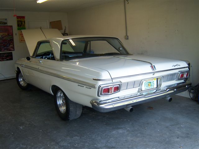

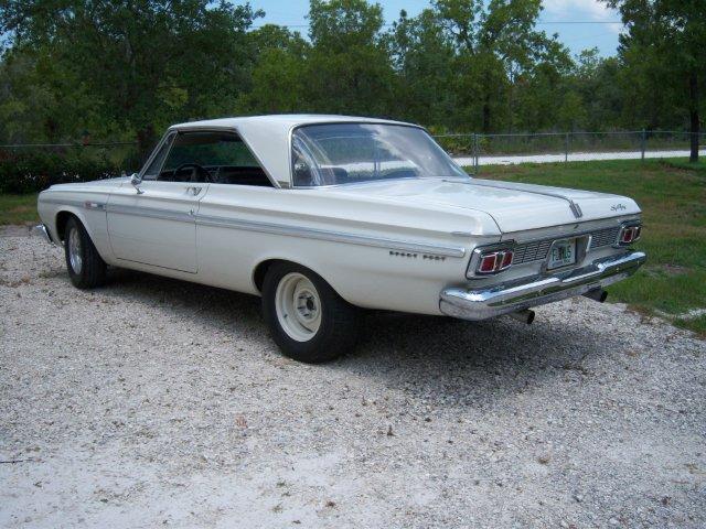

1964 Sport Fury
1974 440 .030 over
cast crank,trw forged pistons
Edelbrock heads,84cc
Hughes cam 505/515 lift 223/230 deg @ .050
full manual 727 w/2500 converter
3.91 locker
750 race demon/performer rpm intake
Hedman headers/full 3 inch exhaust
Run with full exhaust,front and rear sway bars attached
as driven on the street.
Best time 12.12 @110 ,1.76 60 ft
