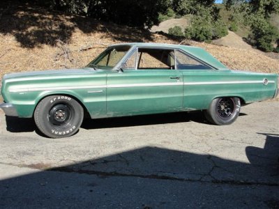

Got any pics of your nice running car ? Ron
Actually yes, but the car doesn't look very nice.
Meep-Meep the car looks fine, add a little more cam, a hotter ignition, adjustable rockers, better carb & a looser converter it could be in the high 11's... It looks like it's driven too me, just not show car quality, I like it !!!!
I agree it not that bad looking at all and I like that body style. And you drive and enjoy it ! Thats what its all about. Ron
Thanks guys. Adjustable rockers are in place. I built this engine as a test to see how the factory six pack will do and as a general long life street engine. Once I get the six pack on and tested this engine is off to its new home and I get a little more crazy.

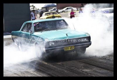

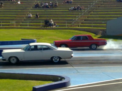

12.1 @ 111mph in a A body
12.7 @ 107mph in a B body (so far)
360
10.5 - 1
Iron Heads ported
Crane Mech cam @ 0.050 lift 250/255
Ol 273 adjustable rocker gear
Torker 2 single plain manifold
750 Holley DP
Crane elect ignit system
Headers into twin 2.5''
Twin Thermo Fans
727
235/15 M/T ET streets
9'' Diff 3.9 gears LSD

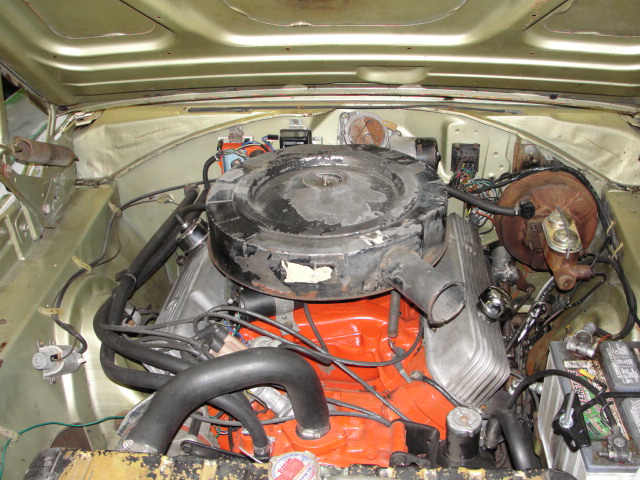

Meep;I'm very impressed that you're running those numbers through that restrictive air cleaner. The combo I'm planning is very similar;your engine specs are close,3.91 gear with the new 9X29.5 slicks are in my plans. I was hoping to run mid-to-high 12's myself;looks like it's possible.
That air cleaner pic was a joke that I sent to someone. What is not evident is the smaller diameter base, which allows the air to enter from under the lid like the factory unsilenced version. I normally run with an open element Moroso but right now I have a late single snorkel with the vacuum flap and the 340 pie tin. It doesn't take much to run high 12's in a 440 B body.

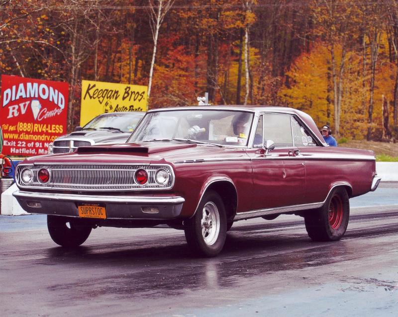

65' Coronet
3675 lbs. w/driver
440-.30 over
Pistons-TRW flat tops
MP 484 Hydraulic Cam
67 915 Heads- 2.14-1.81 valves
(stock stamped steel rockers)
M1 single plane intake
850 holley DP
TTI Headers
Full 3" exhaust w/crossover and flowmasters
727 Trans. w/reverse manual valve body
9 1/2" converter-3500/3800 stall
8 3/4 rear- 4.30 posi
30" M/T Drag Radials
S/S Rear Springs w/ snubber
90/10 Front Drag Shocks
ET 12.00's @ 111 MPH "All Day On Pump Gas" -"Street Driven Regularly"
Easy high 11's with minor tweaking............
Very nice looking, well performing 65 Coronet you have there, mild engine/camshaft combo for sure, those 4.30:1 gears & 9.5" 3800rpm stall must be fun on the street, hope you don't need to get on the freeway much... LOL...
I agree that looks real nice ! Ron
