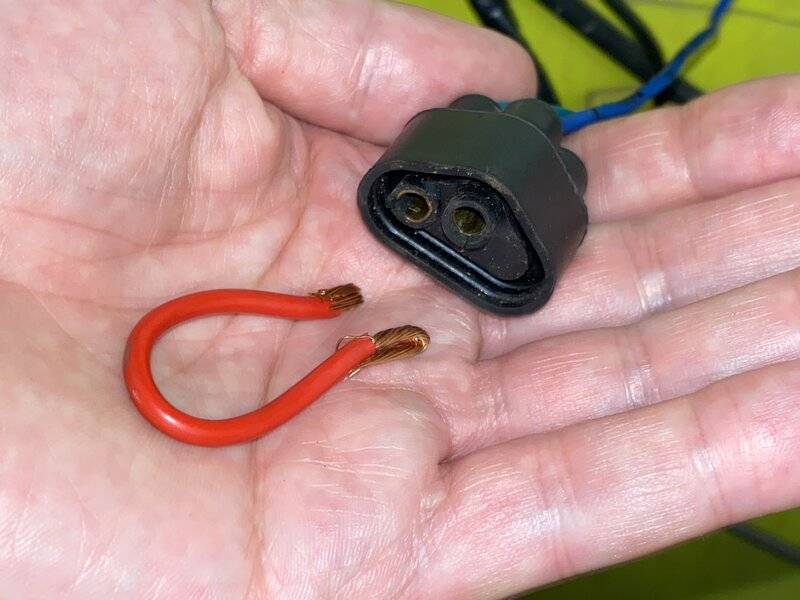

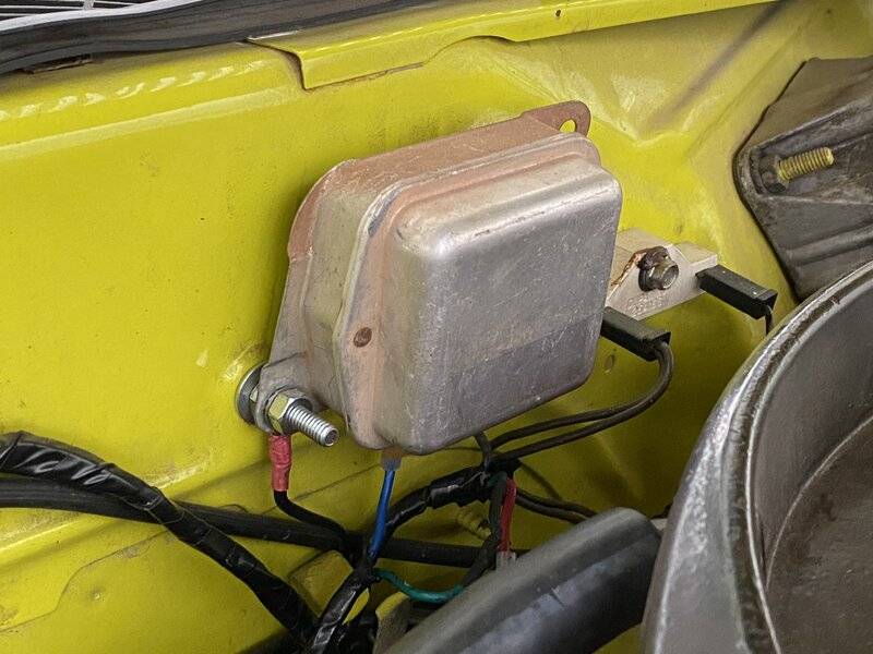

My Bee had a FORD voltage regulator when I bought it. The engine harness was hacked to accommodate this foreign regulator. Part of the hack was a U shaped red wire jammed into the stock regulator harness plug. This red wire fell out shortly before I replaced the entire harness.
A “mechanic” installed the Ford regulator as part of his attempt to get the non operational charging system working.. A fried bulkhead connection was the problem, not the regulator.. A proper Chrysler regulator is now installed.
