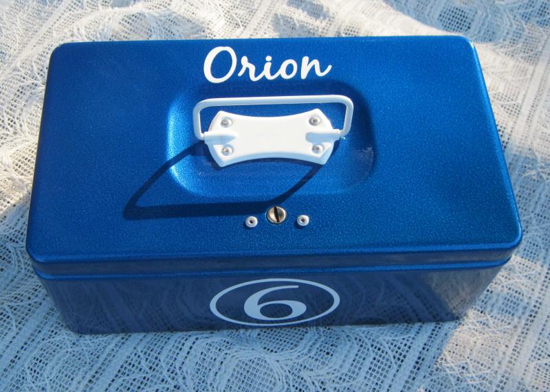

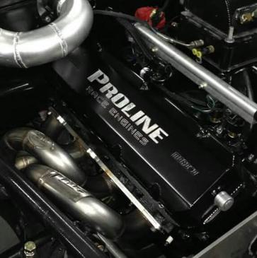

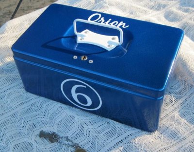

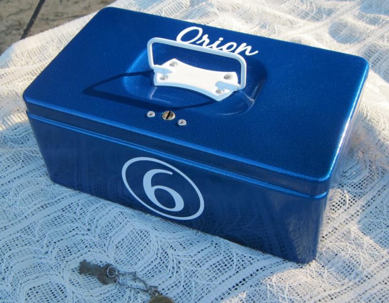

Contrary to what slepr1's local place thinks, you should all know that custom decals can in fact be made out of high temp vinyl that WILL withstand the heat of the cure. I've done this a number of times on various parts and the only ones that don't work out are white like those pictured above -- they'll discolor a bit and look kind of beige instead of bright white. That's why I'm inclined to believe the Murder Nova's are on top, just like the ones on this racer's memory box ...

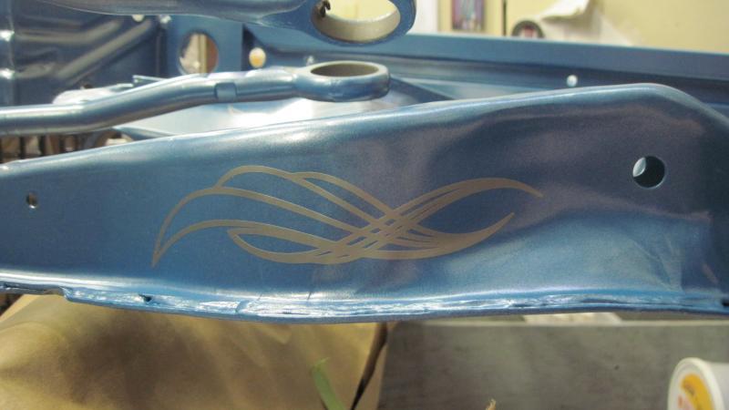

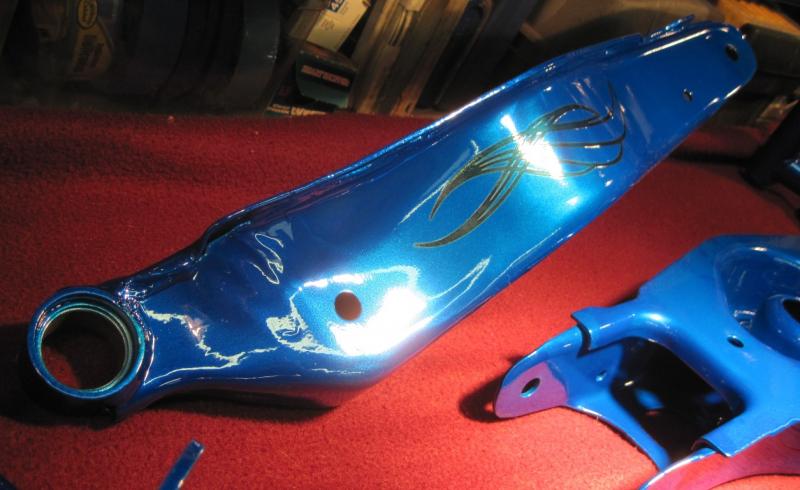

On this Magnum's lower control arm, the decal -- a Harley tank decal my customer purchased on eBay -- was embedded in between the base coat of Illusion Lite Blue ...
... and then covered in a candy topcoat of Peeka Blue ...

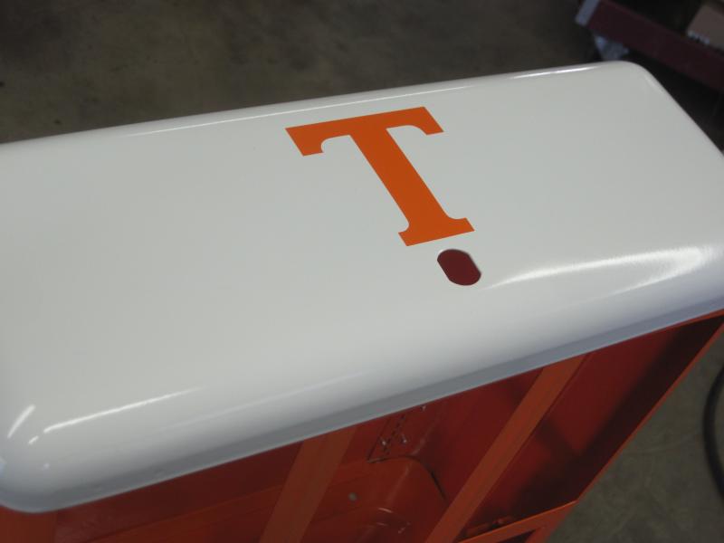

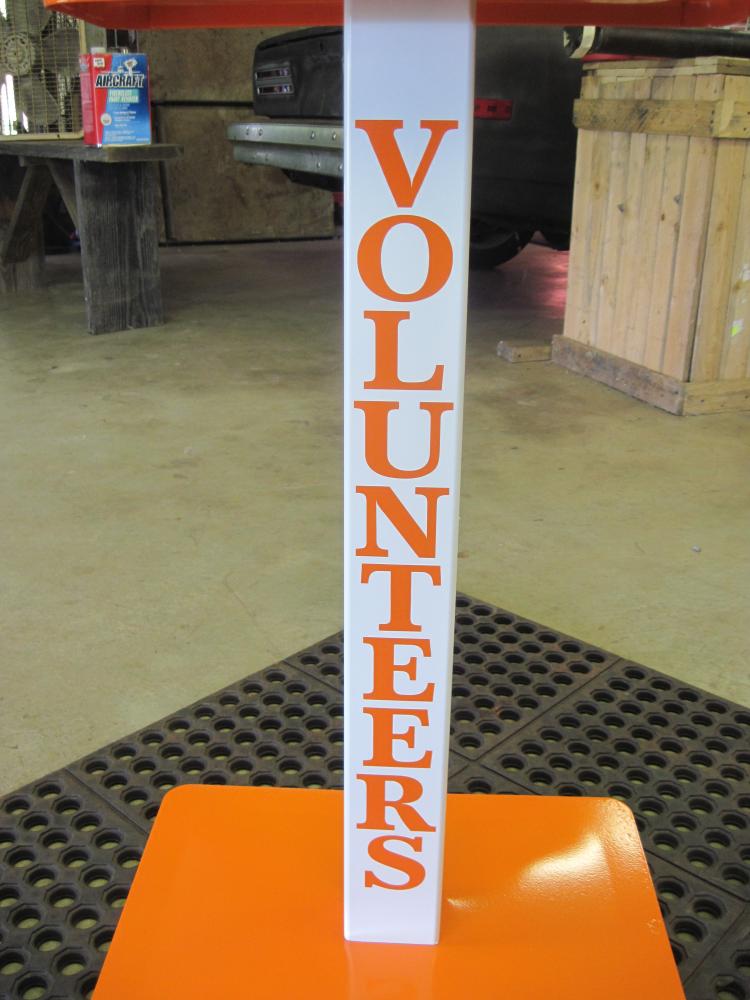

This is another example of a custom vinyl decal installed on top of the powder work.

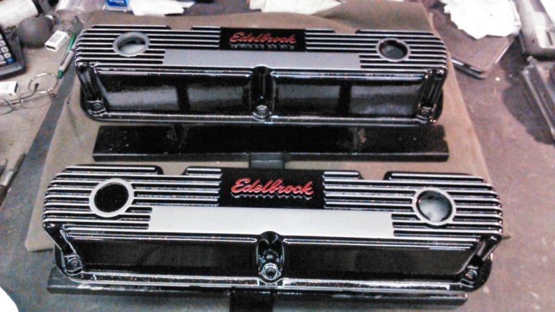

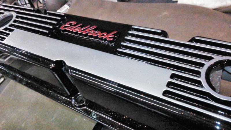

As timing would have it, these one-off custom Old School Edelbrocks with their speedboat style metalflake are getting boxed up today to go to Ontario. I work for motorheads all over the world.

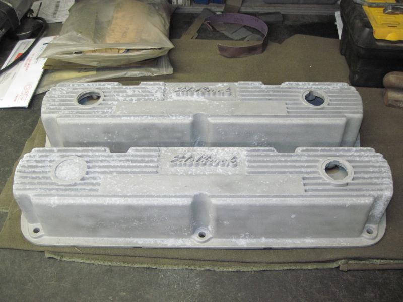

This is what they looked like to start with.

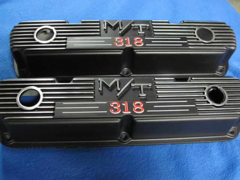

and most of them are left with no protection for the aluminum although I have known a few who clear them afterwards. They aren't decals and most racers wouldn't accept a decal. I've machined a bunch of them over the years.
