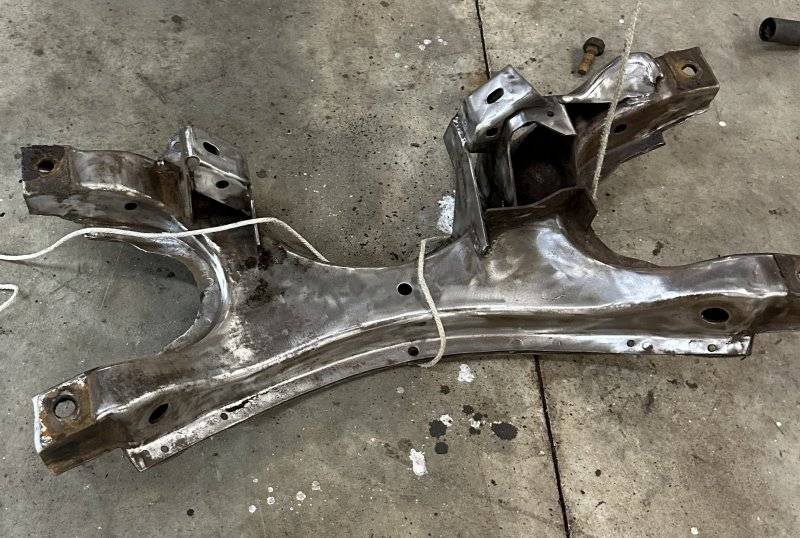

I took my K-member off to finish cleaning the engine compartment and thought I'd reach out to a local guy to see how much it would be to powder coat it. He said $600. I don't want to spend that kind of money so I'm looking for suggestions. What should I use on my K-member? Thanks!

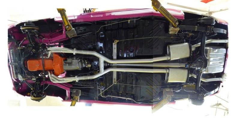

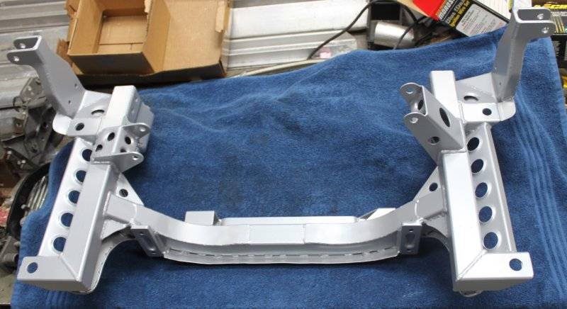

Epoxy primer and single stage urethene. It lasts fovever. My Challenger was done in 2004, racecar 2012. Still looks the same today. The picture of the Challenger was taken 15 years after it was built. Except the exhaust and fuel tank every part you see was painted in single stage urethene.

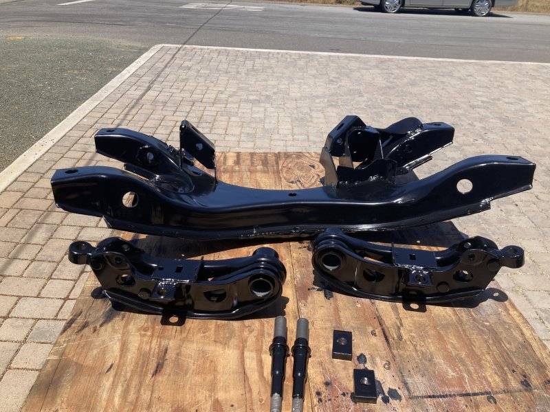

I paid about $150 to powder coat the K Member, it would probably cost more to have it blasted and paint it myself given the price of paint materials these days...

That looks like a Alterkation unit for a slant 6? With extra reinforcement.
