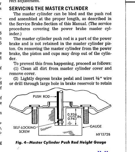

Check the rod gap tolerance btw the booster and MC? Also as was posted, there needs to be slight pedal free-play at the home position to ensure the booster is fully released. Next could be measuring the pedal ratio. Yeah...there's a next; but check this out if ya haven't.
Bendix booster in SM.
