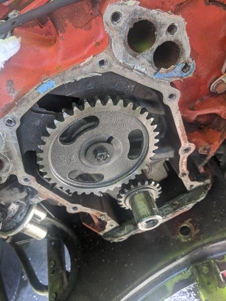

Hello everyone...update on my dead roadrunner... remember it just quit going down the road ...we exhausted the electrical testing ...no luck. Then we decided we better pull distributor cap and crank it...sure enough distributor not spinning...first thought was cam broke or sheared pin...through another thread I found out that cam gear bolt backing out or usage of wrong washer is a real thing...tore it down to timing gear and guess what?...cam sprocket bolt is loose and timing chain is nowhere to be found lol...but my extension magnet pulled it from the murky depths of the oil pan...next up..replace parts. Time it...then compression check with fingers crossed...you experts out there...any chance I get lucky?...just seems very likely to me that in that instant something bent or knocked hole in piston...thanks everyone ..this photo is right after I removed cover

Oh man, my educated guess is you have bent valves and smiley faces on the pistons...
I was gonna say I sure hope it was an automatic when it died on the run... and then I see a picture of three pedals. Doubt the engine's pretty inside...

Yikes!
You should try and boroscope the inside of each chamber.
I would probably just pull the heads off.

Any bent push rods they'll tell where to look. Was thinking same thing as dadsbee.

Do a cylinder pressure test

Thank you everyone...this vehicle is tasking me ...and I shall prevail..likely by dumping loads of money it... compression test first then likely complete teardown

pull all the pushrods and check them, if there all straight I'd reassemble and do a leakdown!put a thermostat in it while your at it!were you paying attention t temps. when failure occured, most of the times I've had valvetrain issues it all began with a hot engine!
