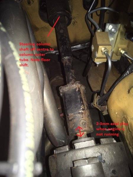

I'm considering my options with the power steering box. The input shaft has 2-3mm of axial play in it when the engine is not running. When the engine is running the play disappears, and input shaft turns seem to have no slop to the pitman arm. Is it normal to have this axial play in the steering input shaft without the power steering pump running? If not, what causes this play - poorly adjusted bearing on the input shaft? Worn recirculating ball assembly? Sector shaft is adjusted all the way down. Would prefer to purchase kit (with new bearings) and do re-build as shipping steering boxes and cores across the Pacific is very expensive and exchange rate is very unfavourable now.
Also, steering column shaft is off centre to the steering column tube. What causes this? Is there a bearing / bush at the bottom? Note coupling is tight.

Loosen the column floor plate to align the shaft and check the front to rear adjustment on the column to dash attachment, it's slotted and may be at the end of travel.

Thanks mate!! It’s amazing when you ask a dumb question how the little light can come on. I had previously loosened the floor plate but didn’t move, which had me stumped. Your answer made me realise that the column mounting screws to dash board need to be loosened to allow the bottom of the column to move. Success.Thanks!!

Some axial play that you have indicated in your picture is normal but not 2-3mm.
My ones are about 1 mm or less in/out. This is needed to tell the box which way to turn.
Start the engine and see if there is any actual play back and forwards of the wheels.
A lot of slop is not good.

Thanks. The Mopar tutorials were informative. With engine running there is no play. Suggests the recirculating ball unit is OK. The 2-3mm axial play may then be the thrust bearing in the power head unit. That should be repairable with a kit.
The only significant issue going forward is the sector shaft adjusted all the way down. Not sure if new sector shaft bearings would help much.
