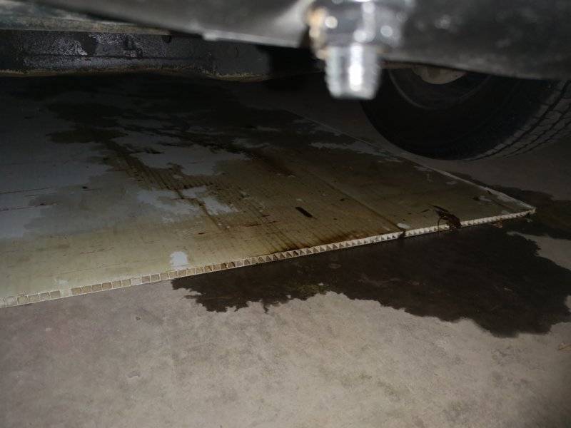

Ok my friend thanks for the information. Reason l mention this subject is my car has been in storage since last October ( l only bought it in September last year) l noticed I had a bit of a leak from my steering box so the owner of the storage facility gave me a big piece of cardboard to put underneath the engine etc. Plus l already had a piece of my own with me so l put both of them underneath the front end.Yesterday he msgd me saying I'd better take some "fluids"with me when l go to pick my car up and said there was quite a bit of fluids under the car and he was going to send me a picture later on which I'm enclosing here hopefully it's just power steering fluid. I'll find out for sure when l go to pick up my car next weekend. I'll keep you guys posted lm gonna be taking power steering fluid-oil and some tranny fluid with me! wish me luck
