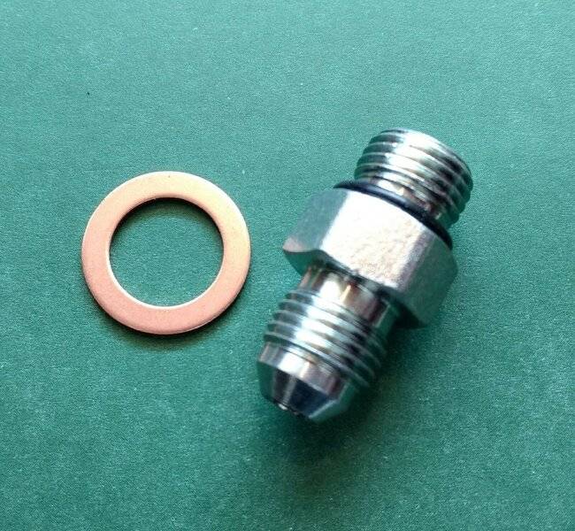

I am looking for this pressure fitting on top of the steering gear to connect to the high pressure hose. Mopar part # 2537386. I would like to find one locally if I can. I am looking for sizing it looks like 1/2-20 threads? the other is an inverted thread, what size is this same?
I see AN fittings on Summitt but I'm not sure if that is what I need.
This is the fitting I'm looking for. Any clues would be appreciated.
Call Bouchillion performance, they sell them (or at least they did). I bought one from them abput 3 years ago.
Or you can check with a local hydraulic supply shop.
Any Hydraulic shop or industrial supply house should have them...
If I can confirm the size then I might be able to look locally, were in lockdown here so only curbside pickup is allowed so you need to know what you want, can't go shopping
The thread in the box is 1/2"-20, the male flare is either 1/4" or 5/16" depending ion the year. I believe the 386 fitting is 5/16", they went to 1/4" on later models.
