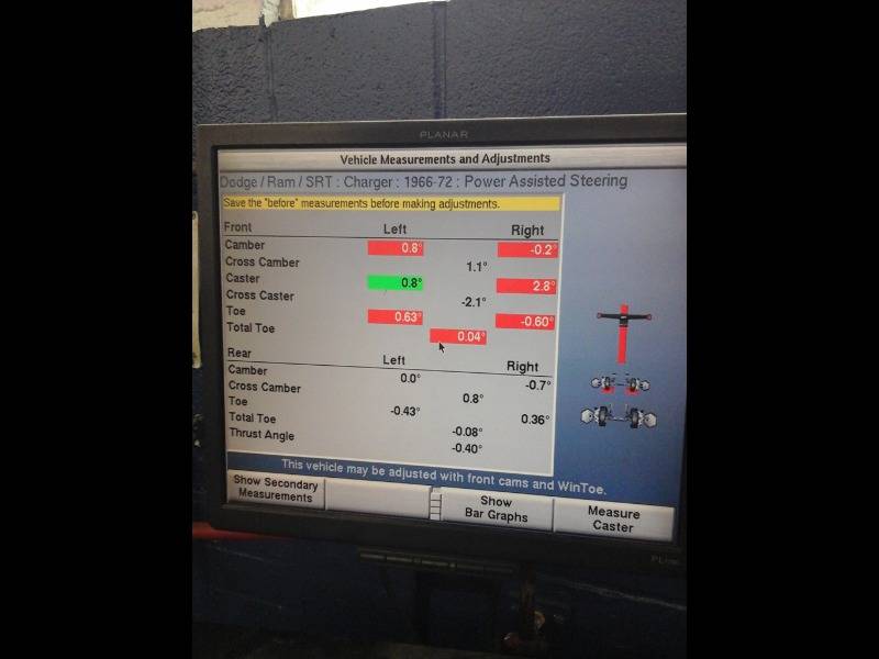

The alignment guy told me the gearbox was pulling, so I took his word for it. When I got it home, I jacked up the front end, started the car up & the wheel stays centered. Looks like I'm a victim of a shitty alignment. :rolleyes:
Time to go elsewhere.

I just took the car to a different alignment shop last week & now the car tracks nice & straight.
Before & after.....

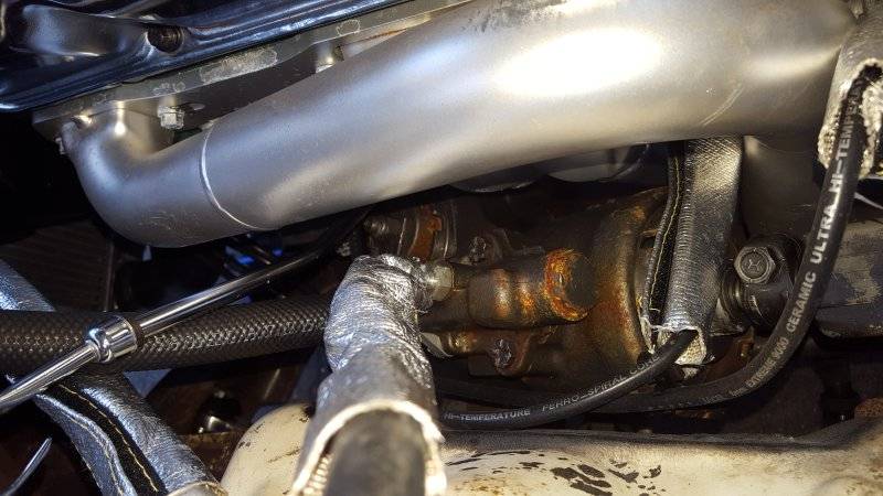

I did a rough alignment today and all if a sudden it's pulling to the right.
Wheels off the ground, steering wheel goes all the way to the right from any starting point.
Didn't pull to the right at all before today.
Everything is new, just over 300 miles on car.
Can someone post a visual of this adjustment?
I've read the FSM and numerous threads and my tiny brain isn't getting it.
Loosen the two bolts in the circle and lightly tap the cover to one side or the other.
If you adjust that KEEP YOUR HANDS OFF THE WHEEL when you start the engine!
I found out the hard way in the mid 70's lol and you can pull the coil wire and just turning the engine over with the starter will tell ya if you're close.....
With the front tires off the ground, I loosened the two bolts and it wouldn't budge at all, left, right, back, forth, nothing. Tried a small prybar with a tiny amount of force, nothing.
It did leak a little fluid.
Tightened the bolts back down, started car, wheels still off the ground, steering wheel doesn't move at all in any position.
Don't know what the deal is, but the issue is gone.
