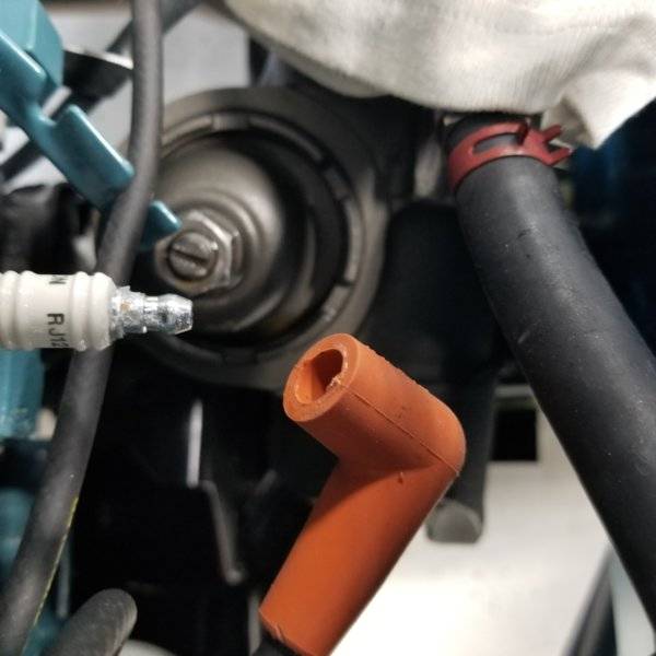

I resealed my ps gearbox on my 68 Charger. The one seal I missed is the oring seal underneath the locknut for the adjustment screw. After startup and running for a short while it started seeping oil out.I pulled the old seal out and it was cracked and hardened from age. Not having the correct seal, I installed a close matching oring. Well, it's starting to seep oil out again.
Does anyone know where I can order the correct seal without buying a complete seal kit?

Did you re seal the gear in the car?
