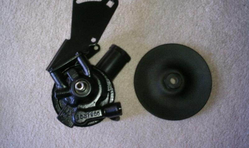

Yes, it is the same pulley that I gave them. Not sure what help a picture will be, but here is one of the pump and pulley.
Very interesting ...
