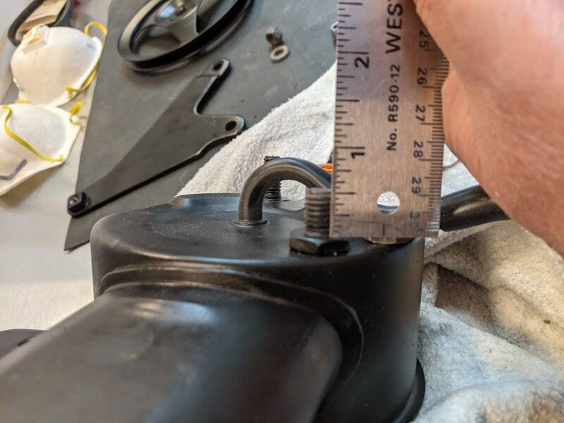

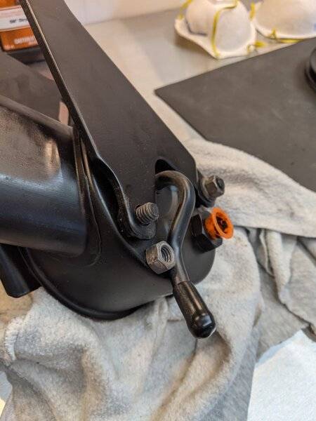

Ok , I'm adding power steering to my car, trying to install my pump and I can't figure out why the nut and washer will not fit on the one stud on the back of the pump. One stud is 1/2 long and the other is 3/4. So the guy who rebuilt the pump, did he reverse that stud, or maybe someone cut it before me. How can I fix this, do I need another stud or is it reversible, or do I need to find another. The nut just barely fits without the washer, I'm assuming there is supposed to be a washer I don't know.
I attached a couple pics.
Any help would be great thanks
Pretty sure the studs should be the same length. I have seen them offered in a kit
So is there an o ring back there ? I've never taken one apart. I won't mess up the seal or anything?
The oring is between the pump and the reservoir
thanks, I'll try and reverse it today, hopefully the other side of the stud is longer
