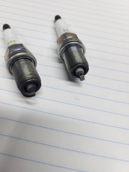

what do the spark plugs say?
I'm rich, really rich. I get tired of messing with it. It's going to be hot for a couple of more days. Will try something else towards the end of the week.
