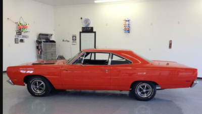

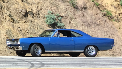

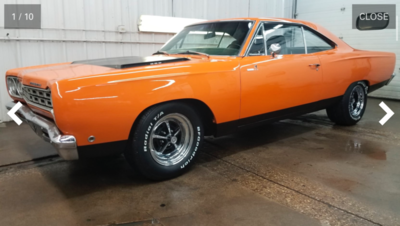

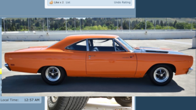

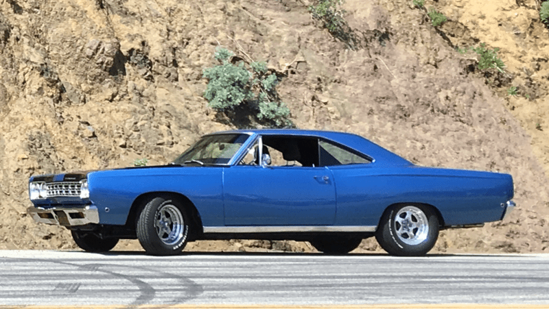

The lighting is not the same as your car’s photo but here are vitamin C cars with RWL tires I found online to give you an idea for your car. I posted your car photo as well so you could view them together.
F401FEC4-E2F3-4B60-BF7A-962D091DB34C.png 51CE9FFE-908B-4A19-98F0-F396DB686ACD.png 597AF077-4A04-4E71-B72A-60F4AC6CC459.png
Man looking at them side by side I like your car best the way it is with those black walls and 255’s out back. I think you should leave it alone:)

Hmm, maybe I should stick with what I've got then? Do you have any photos of that setup (275/60 rear & 235/60 front)? I was actually thinking that I might like another inch in the back, but I don't want something that's going to look odd (you say the 275/60's made the 235/60's look small). You can see my first post here with a pic of what I've got.... it's a good stance, but I was wondering how an extra inch in the back might look.

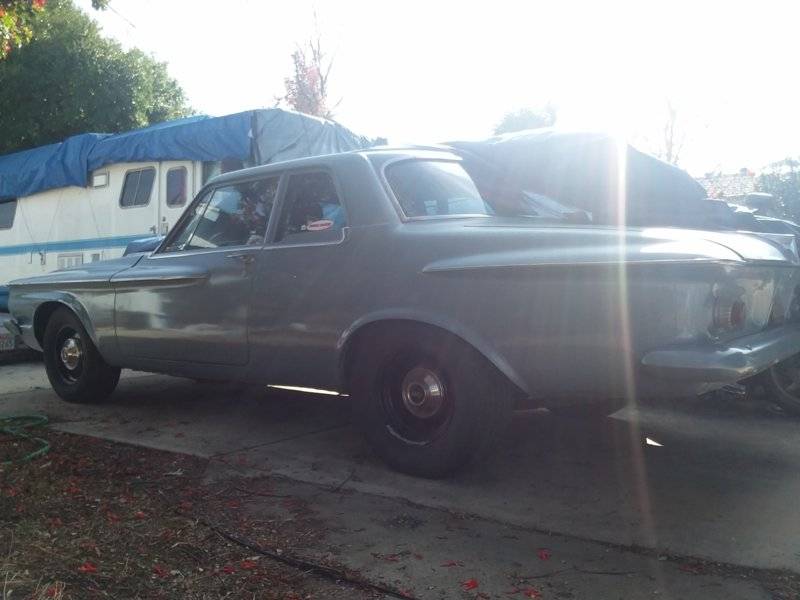

Rick, i cant help with a rr profile shot, but here is a lousy shot of my 62 with 255/70-15 t/a radials on a 8" ramcharger rim, 29" tall, 8" on the ground.
I would have liked wider (275/70) but the backspace prohibited that. The height is essential, 62 has a ridiculously long wheelwell opening, 36" that needs to be filled to look right.
I think your runner will look best with the wheelwell filled, height wise, then as much width as you can get on your wheel of choice. 28"slicks looked great on mine.
