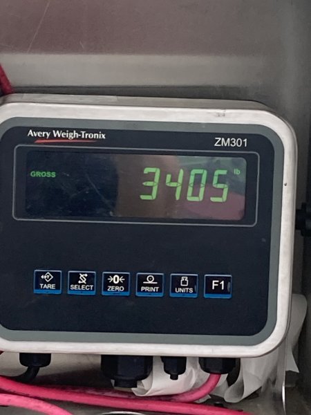

I finally got my car on the scales
3405 with 1465 on the rear.
3655 with me in it.
That’s about 150 less than I thought.
Now I’m a little less proud of my engine.
That gives me hope for racing our 72 charger...I would say that is a respectable weight for a 73.

I would say that's a terrific weight for a big block 73 Charger. About 400 lbs less than I would have guessed.
What engine and whats been removed. I think a base 318 charger was 3,600 pounds.
Original 318 auto car now 413 4speed.
The hood is light weight fiberglass, no hinges.
I’ve just done a lot of common stuff to lighten it.
It has 72 bumpers, only 2 brackets in front instead of 4.
The only interior panels are the front doors. The rest of it I took out along with the headliner and heater box after mice got in it when I had it stored one winter.
Dash is mostly gutted.
It does have factory front bucket seats for now.
I switched it to manual brakes and steering.
Light weight wheels and tires.
It does have 2x2 x1/8 sub frame connectors.

3405 for a 73 Charger with a big block and 4 speed is surprising to me, on the face of it, but manual steering is -60lb, fiberglass hood is -80lb, no HVAC is -40lb, misc. interior, light buckets, 1/2 bumper brackets is another -100lb. Light weight wheels, no spare, no jack, etc. ....It all adds up.
